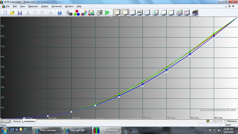

Just got my i1 Display LT in. I haven't put my Lumagen HDP into the chain yet.
The digital projector (VP4001) has 2500 hours on the bulb, which desperately needs to be replaced. I'm using the wide open iris setting due to the medium & low not having enough light output anymore. But I'm going to wait until fall before I replace the bulb (when the good television shows come out).

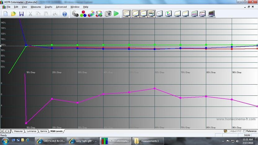

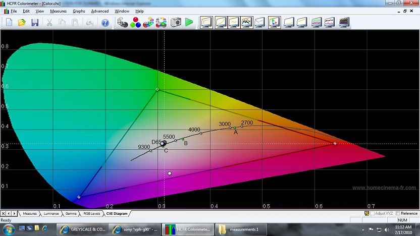

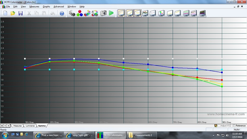

I'm new to calibrating & sensors, btw. Still haven't figured most things out. But I wanted to show you my "before" graphs.
I'm getting a maximum of ~8.0 ft.lamberts at the screen, which is a DIY N8.0 paint formula. That stands for Neutral Grey. Discussed here if you're interested:
http://www.avsforum.com/avs-vb/showthread.php?p=16968940#post16968940
Anyways, I haven't touched brighness or contrast settings or anything else. I did a complete reset on the projector. I then chose the "standard" display setting (choices being cinema, dynamic, etc). And these are my graphs.

Kind of. I'm still the uber-beginner here with the software & meter. I'm really impressed with how well the projector performs with color & greyscale default settings and was looking for confirmation that this is pretty decent.
Or for someone to say "that sucks, you need to do this & this instead....". Razz

Eddie - Out of the box standard mode looks pretty good! Wink I'm trying to talk my neighbor into one of these Marantz pjs. I'd try to get a few more fLs out of it if you could. You should probably be there after getting a new bulb and adjusting your white/black levels.
