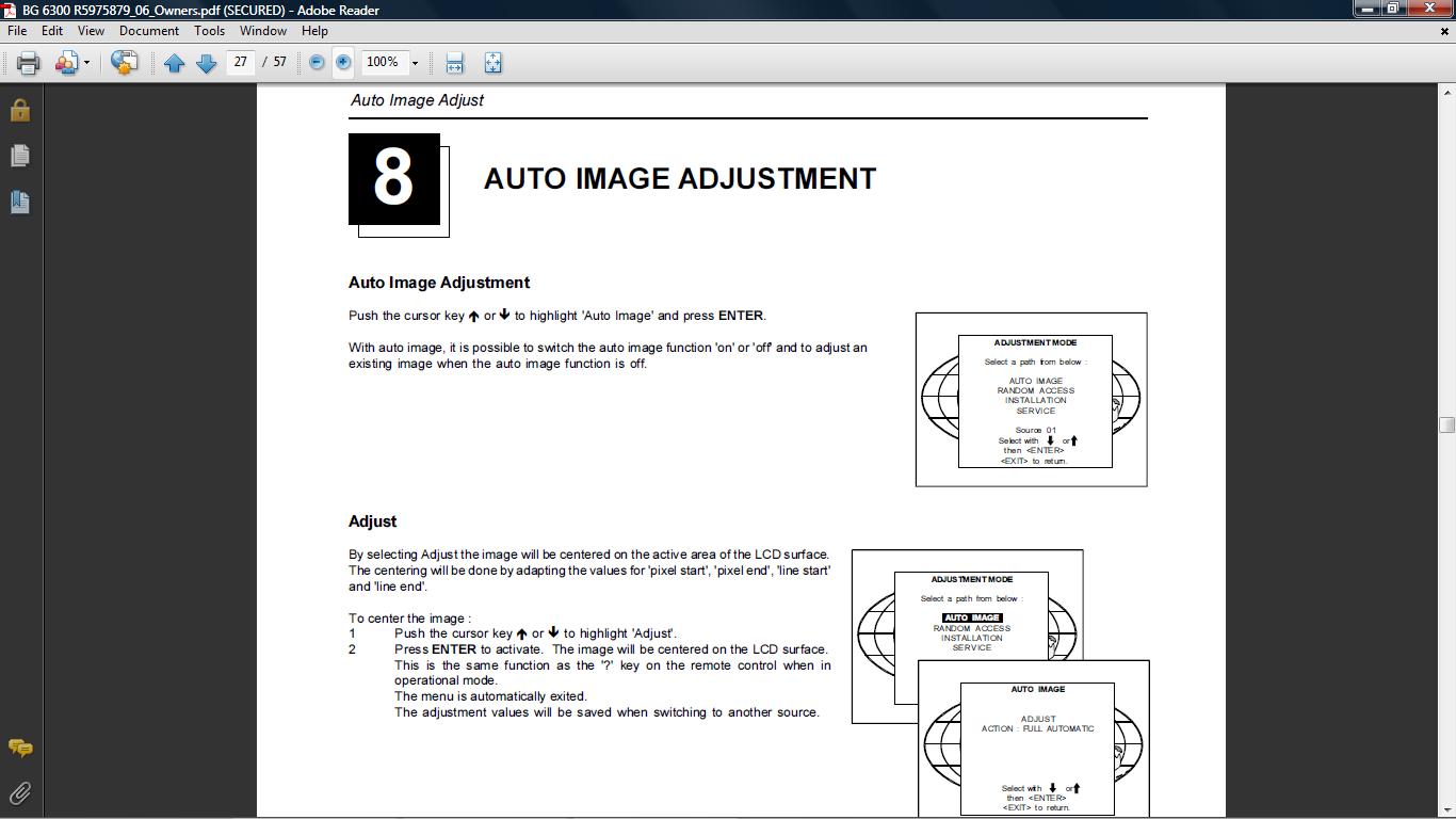

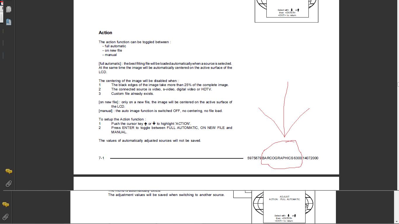

Posted: Sat Jul 03, 2010 5:04 pm    Post subject:
Look here.
 Filesize:  104.5 KB
 Viewed:  18638 Time(s)
 Filesize:  83.61 KB
 Viewed:  18621 Time(s)

I know it's strange but my menus a quite different from the one on the manual. In the menu the projector is called BG6300 TCR+
Anyway, I think the auto image only centres the whole picture; not the independent colours.
Damien
Posted: Sat Jul 03, 2010 8:08 pm    Post subject:
Damien
The TCR+ is just a feature which means True Color Reproduction. Both the BarcoGraphics and BarcoReality had it. There wasn't one without it.
The auto image centers the image on EACH individual LCD panel, which looks to be the problem you have. It really does not look like an out of place panel problem.
