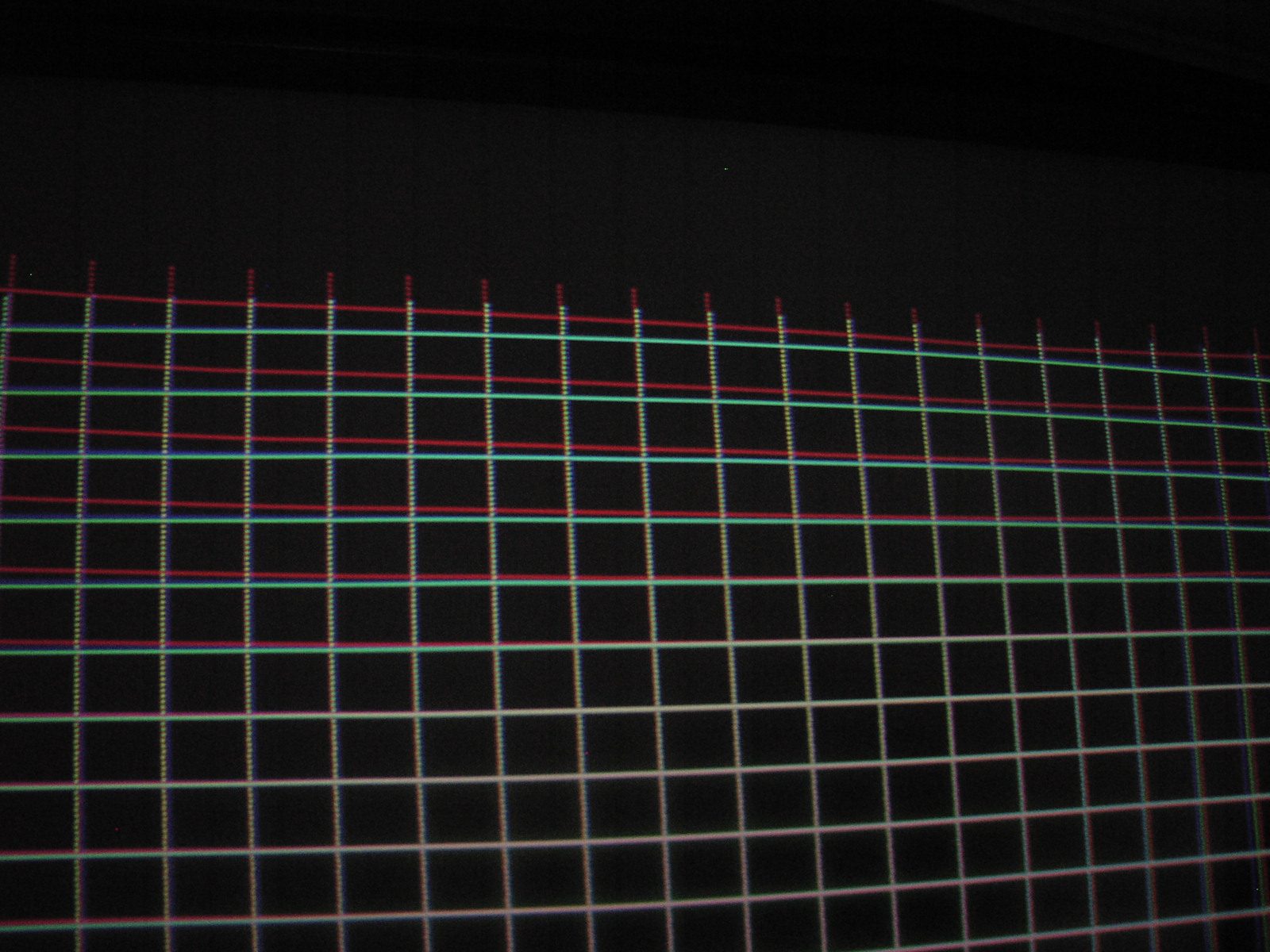

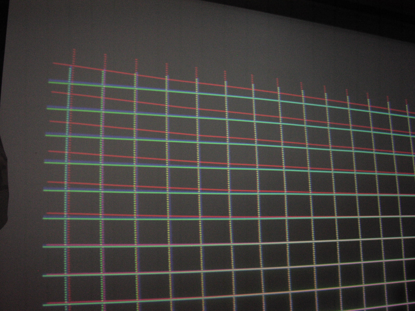

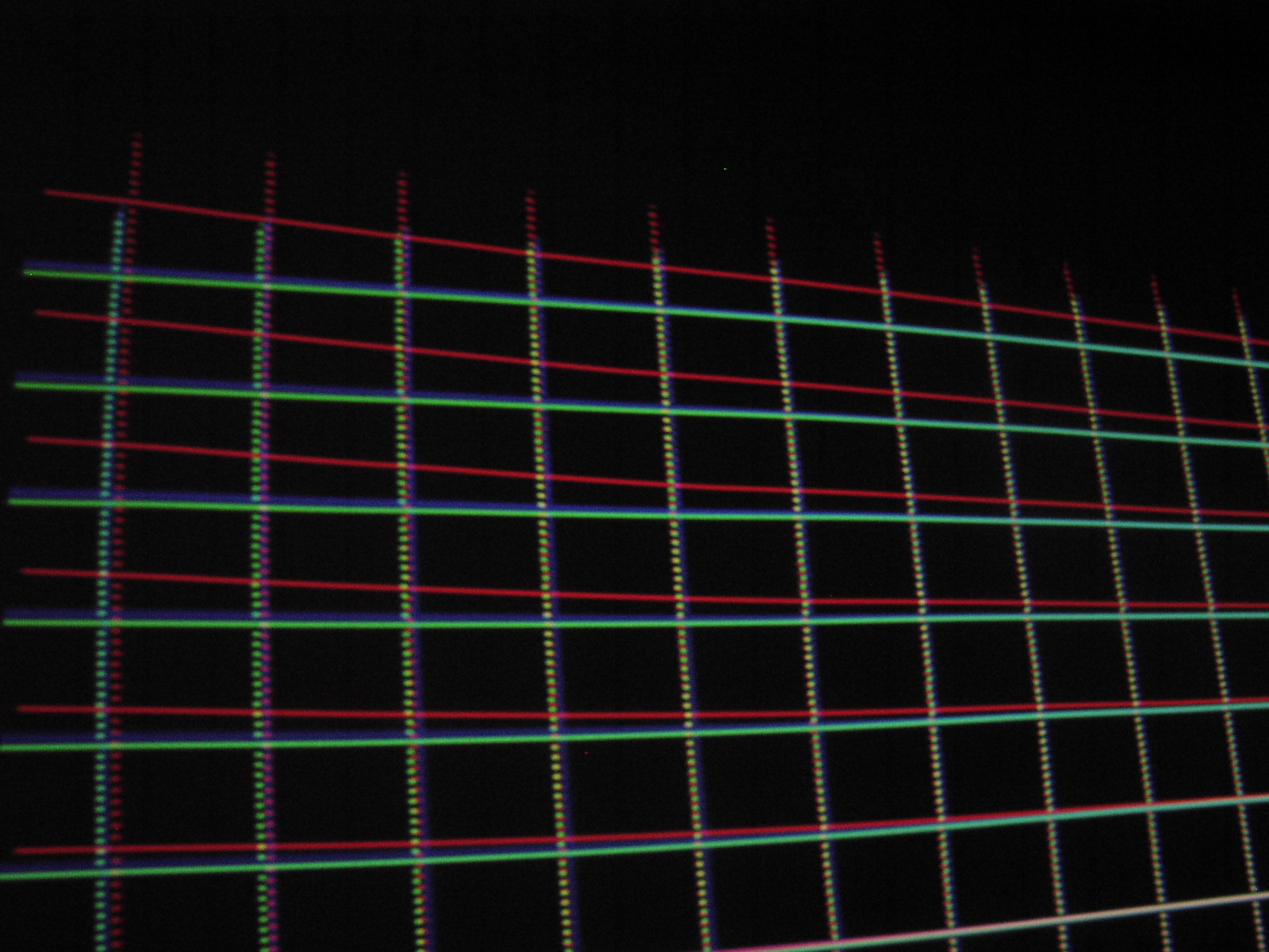

Posted: Tue Sep 19, 2006 1:27 am    Post subject:
Here is a couple of pix. I can not get the lines to move at all. It is only vertical on red,top half of screen. The horizontal lines move as they should.

What's the 8XXXX number of the far right section (looking from behind) of your registration bd? For example my 2000 has an 81289. It should be printed on a small white sticker.
All the registration signals are made from a horizontal freq ramp and a parabola as well as the same signals that are vertical freq. These are divided into left and right signals as well as top and bottom. The circuit that handles your top red part is not working for some reason. Can be narrowed down to a specific part of the board.
