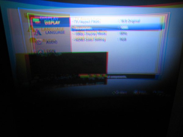

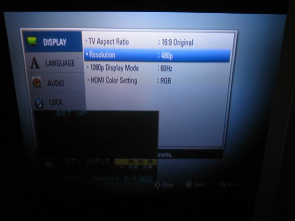

Ahhh ha! He just sent me these two pictures:
Looks like the TV isn't switching over to 1080i memory location.

Posted: Fri Apr 30, 2010 12:39 am    Post subject:
What that is, is that the tv was never aligned and converged for 1080i. I believe this tv upconverts 480i to 480p but sends 1080i direct through. So 1080i has to be set up.
Tell him to try the flash focus while sending it that 1080i signal.

I'm guessing that since that second picture shows it acknowledging a 1080i signal it is going to have to be aligned. It may have never been set up originally. I often find I have to align the DTV input on these RPTV's.
