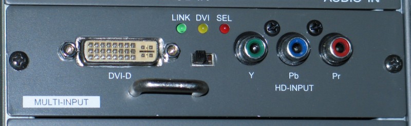

Posted: Thu Apr 08, 2010 4:37 pm    Post subject:
CIR Engineering wrote:
Just for laughs, here is a Moome v1.72 from several years ago.
HAHAHA. And people actually thought it looked good. The HDF1 absolutely blew this Moome card out of the water. I am glad Moome got better with time Wink
craigr
Is that the DVI/Component input card?
It is one of them. I think Moome had at least two different DVI / analog component IFB's.
