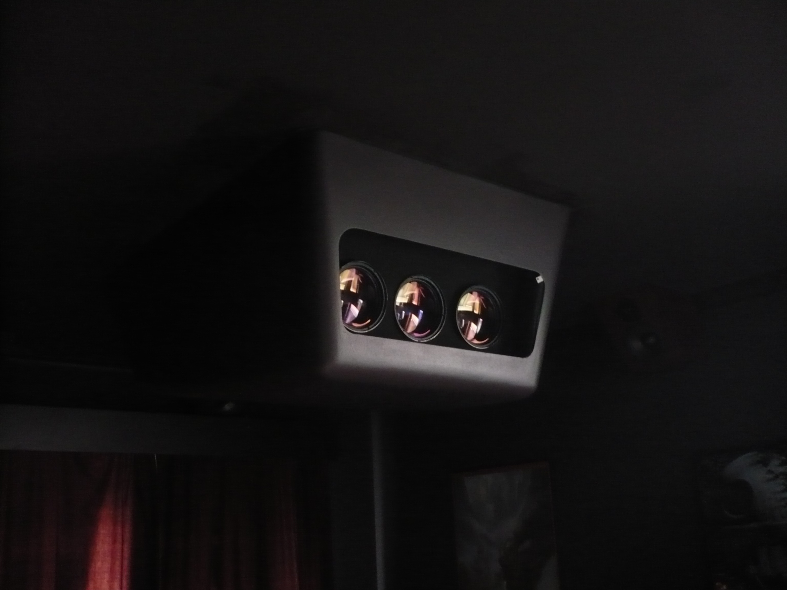

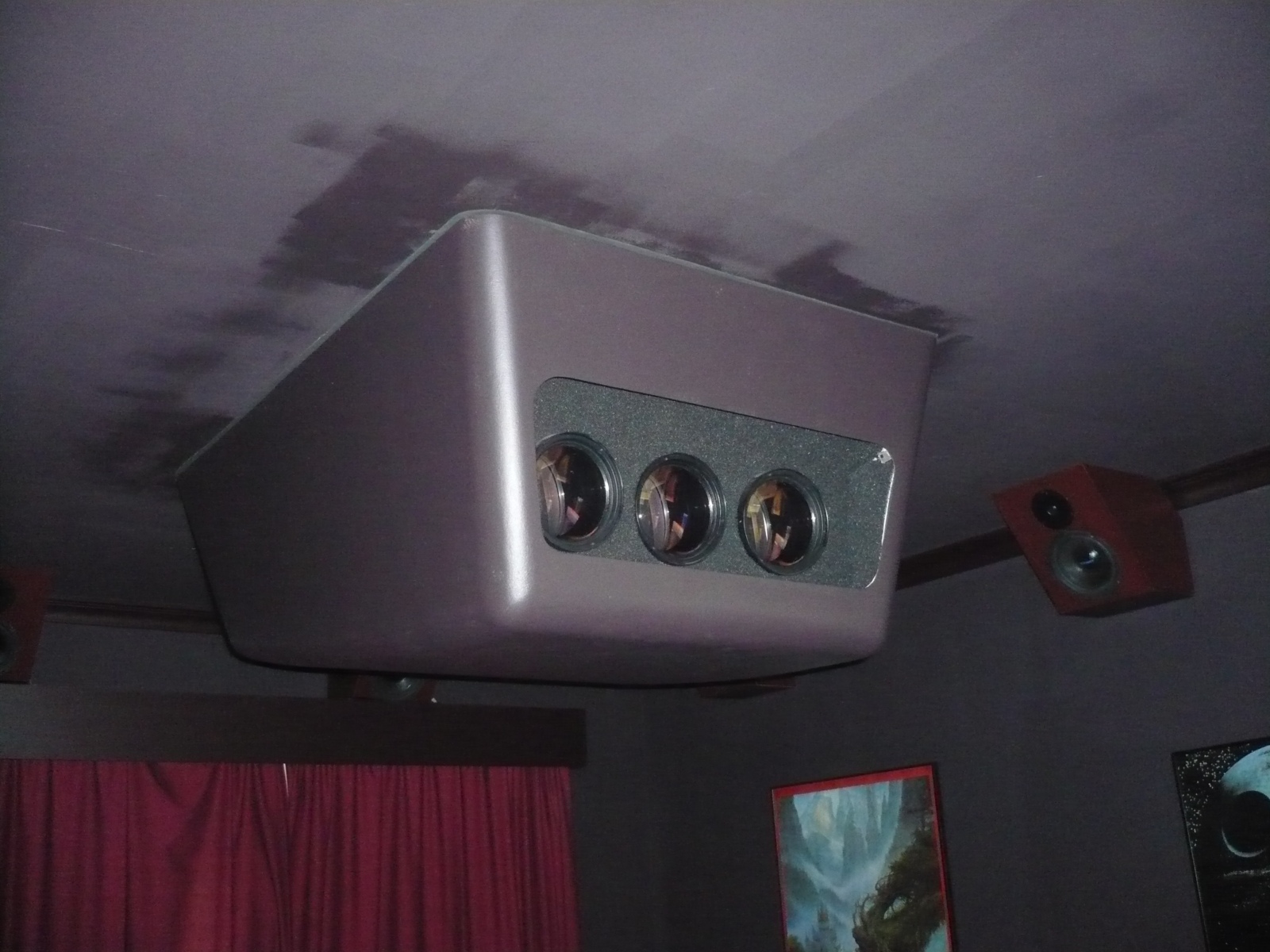

Here is my fibreglass hushbox.
Flash shows you the details, but also brings out the paint touch-up which is not visible to the naked eye.
Nice looking hushbox. But it kinda reminds me of something out of the 70's.

Mark_A_W
Joined: 15 Mar 2006
Posts: 3068
Posted: Sat Mar 13, 2010 11:54 pm    Post subject:
It's the matt paint, it marks easily.
