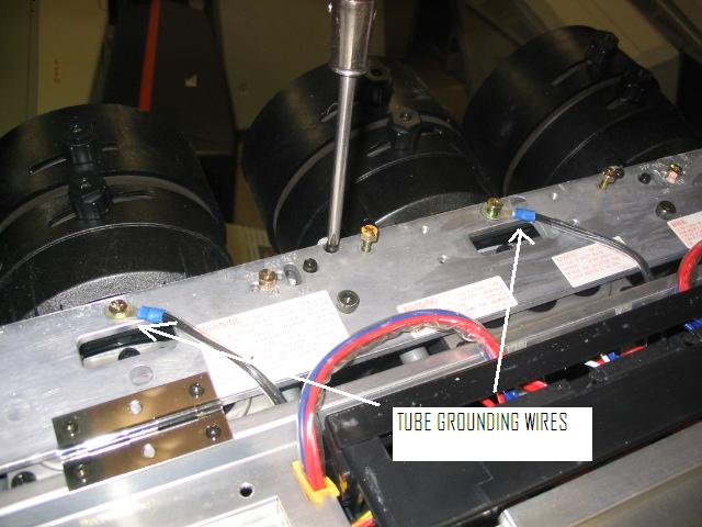

yes absolutely, the tube HAS to be grounded to the chassis in some form or another. Different manufacturers do it in different ways but basically your pulling the static charge off the tube bell to ground

very likely that's the problem. The charge on the bell doesn't start immediately, but takes time ot build up. Then when it's ready it will arc-over. If you have non-sony tubes then you need to look a the old tubes carefully and se what kind of tube-ground sony used. I remember on the G70 it was just a heavilly insulated wire from the tube to the chassis.

They are Sony tubes, but i think you mean that they came from an Electrohome originally instead of a Sony.
Thanks alot for your input Draganm, youve given me new hope that i may be able to get the old girl going again!! Smile
