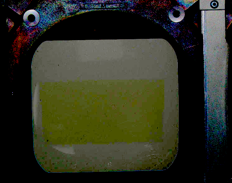

Posted: Wed Mar 03, 2010 9:41 pm    Post subject:
It's hard to see the wear pattern properly in those pics so i enhanced them to show up what phosphur wear it has. You can see it was running a 16:9 screen, and not correctly positioned! But still not bad overall. You'd never detect anything on your screen.

Posted: Thu Mar 04, 2010 3:36 am    Post subject:
Thanks mate yeah that shows what im refering to, it is very light wear, but i think its still wear enough to be seen if it was used in 4:3.
