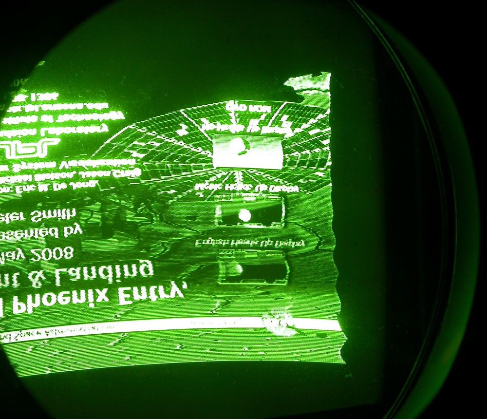

Ok, so with the replacement H output board I bought from Curt, I'm getting an image. Yeah! But I'm getting a weird wavy distortion that I haven't seen before. I've attached a photo taken looking into the lens of the green tube with a DVD home screen input. But I also tried another input (computer) and got the same distortion.
Any ideas? I'm sure it's probably just an adjustment somewhere. But I don't know enough to find a reference to it in the documentation.

Posted: Tue Apr 06, 2010 7:55 pm    Post subject:
Were you getting this with the 801 board? That looks like it's an issue contained within the H board, maybe there's a compatibility problem?
Also, that pix looks like video or Svideo. Have you tried an RGB signal, or are you running RGB on that set?
