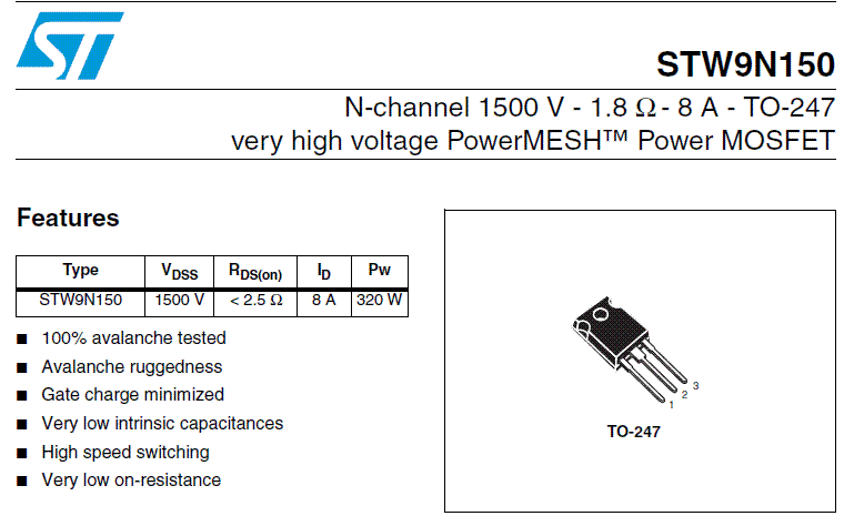

To make the retrace time shorter the "flyback" pulse, on the HOT output board, has to increase in voltage. The factory parts are rated at 1100V. So if higher voltage mosfets are available the flyback could be shortened with a capacitor value change.

I did a little looking and it might be possible. Downside would be slightly worse horizontal linearity at lower sweep rates but probably not an issue at 1080p. Then there is the danger of mucking with deflection circuits. It would be wise to do the testing with a unit that has CRTs that you don't care about. Anyhow, the math works out.

So would there still be a need for some cap changes? And if so what caps and values?
Oh I see it now, Cfb.

I assume you are talking about Q-12 through Q-16 and Q-18. You tell me what caps to order and replace and I'll play mad scientist and experiment on my own stuff.....(mad scientist laugh) Laughing
