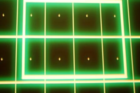

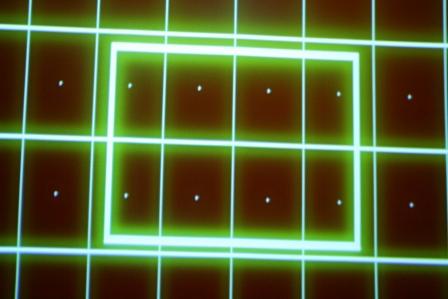

Hey guys.
I have a problem that I havent dealt with since I got my projector fixed. its a marquee 9500 lc ultra
What is up with the green aura ocurring during convergence?
Whenever I watch a movie During light scenes or scenes where theres a lot of white a green aura occurs aound the area.

Posted: Sun Jan 31, 2010 9:13 pm    Post subject:
Green on focus board might be out, swap it with the red and see what happens.
Posted: Sun Jan 31, 2010 9:17 pm    Post subject:
Glycol contamination..
The actual grid is well focused and defined. The glow is either a tube or glycol - what does the Glycol look like?
Posted: Sun Jan 31, 2010 9:22 pm    Post subject:
I think the focus looks OK but the halo looks just like what happens when the coolant gets yellowed and cloudy. Since it's behind a green tinted C element, you won't be able to see the color change but the murkiness should be evident by lowering the contrast and looking into the lens at close range.
This same thing is slowly happening to my own machine. But I've got upgrades to do in a couple of weeks so I'll deal with it all at once.
CJ
Posted: Sun Jan 31, 2010 9:34 pm    Post subject:
Yepp you guys are right, i didn't look to close .
Posted: Sun Jan 31, 2010 9:38 pm    Post subject:
yes the Focus board is fine, I had it here and tested/worked on it. It is possible to replace the Glycol with the machine on the ceiling isn't it?
You can see how yellow it is even in the picture.

moby
Joined: 18 Nov 2008
Posts: 64
Posted: Sun Jan 31, 2010 10:01 pm    Post subject:
I just had my glycol changed on all three tubes when it was set up. Has it been done wrong somehow?

Posted: Sun Jan 31, 2010 10:41 pm    Post subject:
Were the L/C chambers taken apart and cleaned, or just flushed and re-filled?
If not disassembled, some contaminant could have remained in the chamber?

moby
Joined: 18 Nov 2008
Posts: 64
Posted: Mon Feb 01, 2010 9:29 am    Post subject:
dturco wrote:
They were all taken apart and cleaned.
http://www.curtpalme.com/forum/viewtopic.php?p=171911
Posted: Mon Feb 01, 2010 10:49 am    Post subject:
Well if its not the glycol then check the focus board or VNB by swapping cables from one color to the other on the focus board and swap the vnb's from the red to green tube. This could be a bad tube as well now.
Also what is your contrast level set to? and recheck your G2 levels for green again.

Posted: Mon Feb 01, 2010 2:54 pm    Post subject:
It is hard to tell from a photo because it could be over exposed, but in the photo it looks like the green is being driven too hard. Are the magnetics well setup and is the contrast below 60?

Andreas33
Joined: 18 Sep 2006
Posts: 17
Posted: Mon Feb 01, 2010 3:48 pm    Post subject:
Maybe G2 settings too high ?

Posted: Mon Feb 01, 2010 4:02 pm    Post subject:
The grid lines are clean and sharp. Focus isn't the problem here. There's contamination in the optical path. It's most likely to be murky glycol but it could be a dirty lens element, too.
