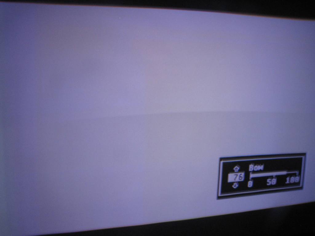

I want to show you guys a picture of a full white screen of my Marquee 8500:
Am I correct in assuming this isn't the notorious banding issue caused by the use of Bow?
I am seeing this (looks more dramatic on camera than it does in real life) on all resolutions.
What could it be?
Grtx, Elwin
PS. the brown blob is a feature of my camera.

Was this projector ceiling mounted before and now you have it on the floor or vice versa? That looks like a windows task bar burnt into the tubes.

Nope, that is the classic Marquee banding.
read this and try your best shot.
http://www.etechvideo.com/techtip10.htm

Alright! I already thought it was banding but playing with Bow didn't solve anything...
Must have been the convergence tweaks I made to the green raster.
It's fine now after resetting the convergence, thanks!
that brown stripe is the CRT re-fresh scan. You have to set the camera for shutter priority 8 to get rid of it. Took me a while yesterday to figure this out which is Ironic because I was trying to actually take a picture of banding. When you use too mcuh Bow you usually get only 1 big band in the middle. BTW, the brown stripe on the left is actual wear in his pic Smile
