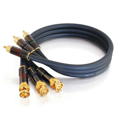

I've never tried that before. So, if I understand you correctly, you can connect a component source directly into 3 of the BNC inputs (the R, G, and B inputs) via a cable. I did a quick search to find an appropriate cable that has RCA connectors on one end (the likely connector on the source item like a DVD player or HD DVR) and have BNC connectors on the other end (which is the type of connection on the Barco unit).
This is what I found. Will this do the trick without needing any kind of input on the sync portion of the BNC inputs? I would love to see a 720p or 1080i image on the unit to see the difference from 480p. If this does the job, I'll feel like giving you one of Elaine's patented 2-handed shoulder shoves while yelling "get out!" Thumbs Up
Yes, it works. I've got a 708 as well and have hooked it up to an old xbox (running XBMC) via component at 1080i.

Posted: Thu Jan 28, 2010 6:42 pm    Post subject:
Yes, that's what you need, and don't blow a wad on them either, you can get the same thing at monoprice.com CHEAP, or if you're in Canada, stop by a Princess Auto and look in the Surplus section, they've had some nice BNC to RCA component cables there for a while now at about $8.
Not EVERY single 7xx projector *can* take component direct, I think, but the majority of them can. Don't ask me how to tell which will and which won't, but I do recall I've run across at least one which didn't. I think it was a really early 700 model, but I'm not sure it was a long time ago.
Also, I'm not totally sure it is input number "5" so try other numbers when you have your source hooked up. I think it tells you somewhere in the Operators manual which numbers correspond to which inputs, but its been a while since I looked at that manual too...
Here's the monoprice option: http://www.monoprice.com/products/product.asp?c_id=102&cp_id=10203&cs_id=1020308&p_id=623&seq=1&format=2 Three of those cost you $6. and change plus shipping....

The warnings you're talking about are because people get the different SIGNAL TYPES confused.
Component refers to a SIGNAL TYPE, it is a signal which combines sync with the luminance signal (Y) of a color system such as YPbPr.
RGB is a SIGNAL TYPE which carries the sync portion of the signal either separately on Horizontal and Vertical channels, or combined into one Synch signal with BOTH H and V sync signals, or one other variation combines the two sync signals and places them both on the G color channel.
RGB and component signals are different. USUALLY, if you have a device where there are 5 connectors, you CAN'T use a component signal, but SOME devices, like your projector, allow you to use EITHER type of signal. I happen to have a Philips HDTV that also allows both types of signals, but usually it is one OR the other, not both...
