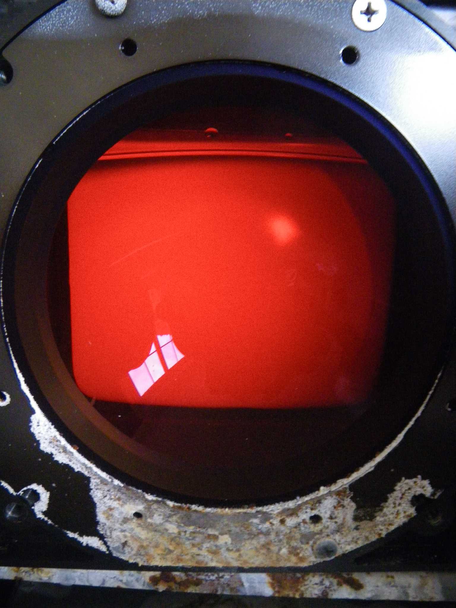

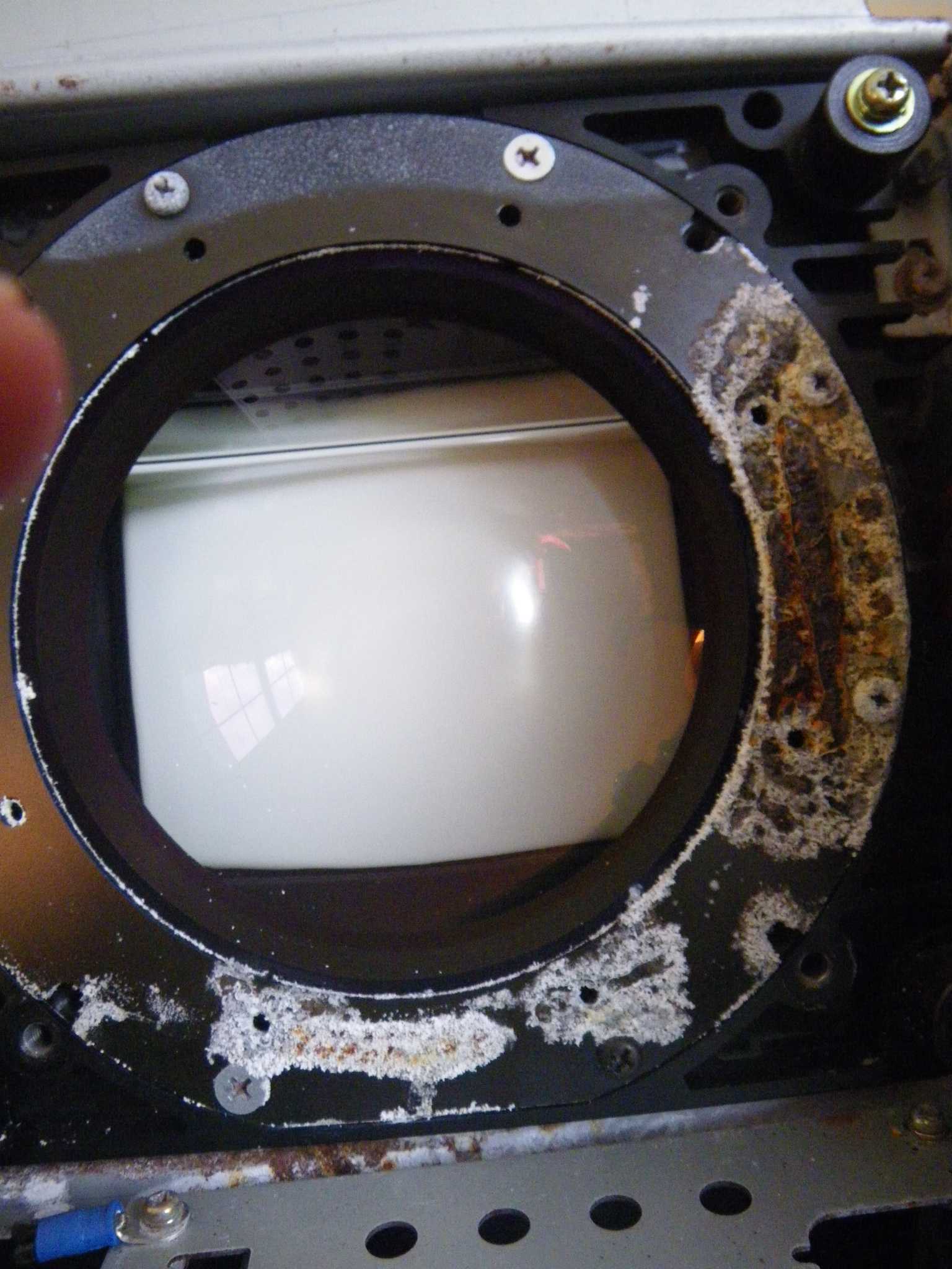

Sorry to resurrect such an old thread, but I finally got a chance to open up the projector and I've attached pictures of what I found after taking the lenses off. Sad
It looks to me like the red and blue tubes have leaked some glycol, as the air bubbles in them are way too large, and the orange color of the fluid I saw initially must be due to all of the corrosion and rusting of the metal parts it ran over.
Also, I can't tell if the green tube is full of fluid or completely empty. Seeing the bulge in the rubber at the top makes me think it too had some kind of issue.
So what is everyone's professional opinion on what I can do to get this set back up and running? There's no visible wear on the red and blue tubes, and only very light square-shaped wear on the green, so I really want to get it fixed. Any and all ideas welcome. I can take more pictures if needed.
Let me know at what kinds of stores I might be able to find the appropriate supplies as well.
Blue tube, larger bubble

Green tube, no bubble

Red tube, large bubble

Overview of damage

Posted: Sun Jun 19, 2011 8:43 pm    Post subject:
Wow, that's.. ugly. I've had a few LC sets have a tiny bit of leakage, but nothing like that. The good news is, your tubes are in really good shape otherwise.
What I would do is pull all the tubes out, drain the glycol, remove the C lenses, clean/scrape all the corrosion off, fill the tubes with water, and put all the screws back. I put tubes on paper towel, as that will easily show you if there's a leak somewhere. Rotate the tubes every 24 hours to see if any more leakage happens. If not, then drain the water and refill with glycol.

Second: Could this have caused circuit board damage if it's been there a long time?
Sean
yes it will eat circuit boards if it gets on them. I would be worried about the power supply's in front, make sure they're not full of Glycol.
http://www.curtpalme.com/NECXG_Layout6.shtm
