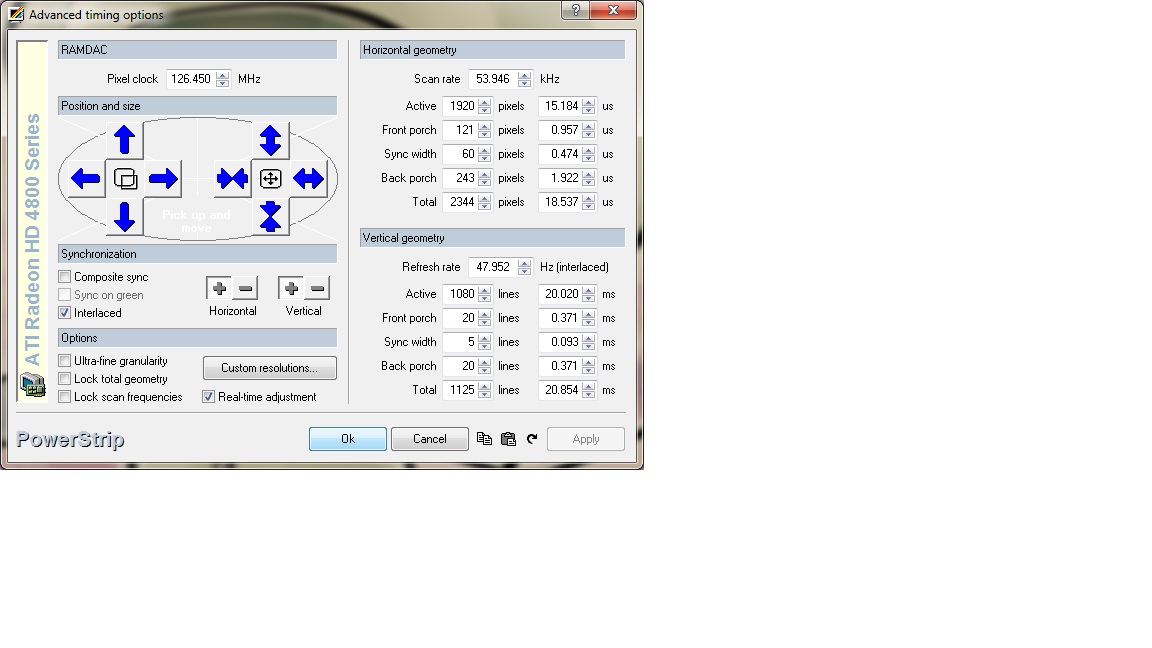

Here are the corrected XG 96i settings.

I do this already with 96i. 120i is more bandwidth so you will run out of porch options before it is as big as the 96i setting. But I will screw with it tonight for fun anyway again.
If I recall, there is not big difference in the image, with 120i being softer, and 96i actually being better.
