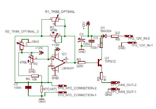

I decided to design controller that starts fan at certain temperature and then tries to keep heatsink temperature steady.
(Look at this pdf ->1031 marquee rearheatsink fan controller 12v.pdf)
It is based to NTC-resistor that is connected to "voltage divider"(Ntc+R4) and that voltage is feedet to OP-ampīs inverting input.
Noninverting input gets adjustable "reference voltage" from R2 trimmer, that trimmer sets temperature point where fan is started. R1 trimmer is there to adjust gain of corretion (temperature/voltage to fan) without it (infinity resistance) that acts much like comparator-> fan on or off
Output of OP-amp is connected to base of transistor Q1 via r3 (220ohm) transistor acts like current amp. rest of componencs are for filtering (c3,c1) R1 (2,2ohm) is there for filtering+ it acts like fuse also (fusible 0.5w) D1 is there for correct polarity (ie. connecting voltages reversed does not harm any components) And those optional trimmers are just for alternative type of trimmers for board.

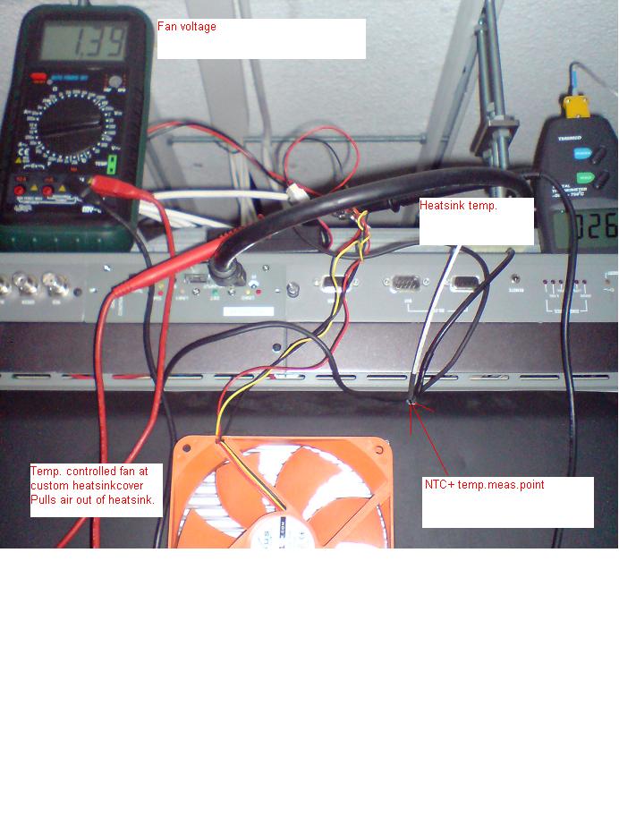

Here is how it works:
Time / Temperature / voltage to fan/ does fan spinn
17.55 / 24 / 1,39 / No
18.00/ 25 / 1,39 / No
18.05/ 30 / 1,40 / No
18.10/ 34 / 2,35 / No
18.12/ 35 / 4,70 / No
18.13/ 36 / 5,90 / No
18.14/ 36,5 / 7,30 / Yes
18.15/ 37 / 7,75 / Yes
18.20/ 38 / 8.80 / Yes
18.25/ 38 / 8,82 /Yes
12.30/ 38 / 8,88 / Yes
18.40/ 39 / 8,97 / Yes
19.00/ 39 / 9,10 /Yes

Here are scematics and board layout pictures

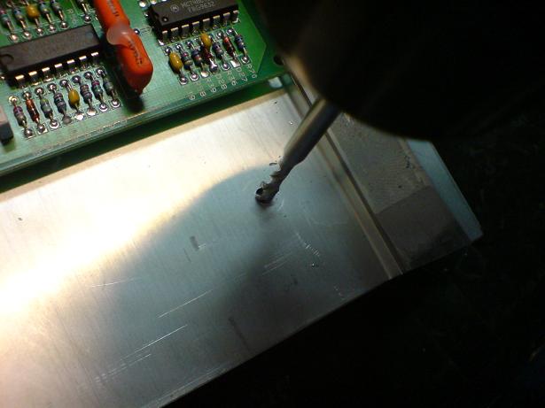

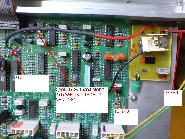

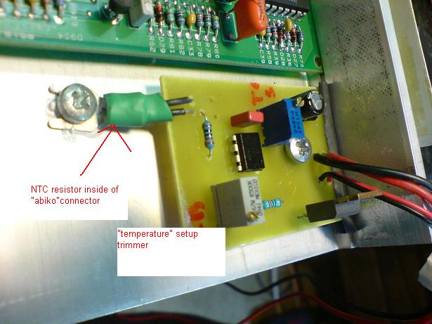

Little update. here is how i installed that card.
