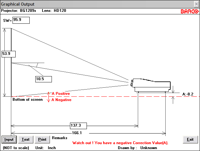

I am unable to run the software for the Barco screen size calculator on my computer so I ran the numbers using the formula in the manual. Can someone let me know if my figures are correct based on the "standard" lens that should have come with the 1209s?
SW (screen width) x 1.311 + 13.029
96 x 1.311 + 13.029 = 138.89
So I come up with the pj needing to be about 139" from the screen for a 110" diagnol screen. My current Sony D50 is about 106" from the screen for a 110" screen. I do not have the room to put the pj further from the screen and would actually need to have the front of the Barco closer than the 106" due to the additional length. Are there any short throw lenses that would help with this that don't cost an arm and a leg?

If we are talking about a 110" diagonal screen 16/9 that's what the LENS software gives (see attachement)
Apparenty only the HD120 and the HD300 can produce a picture of 110" and they both have the same throw distance for that size. For the two other type of lenses available in the LENS (HD10L and HD180), 110" diagonal is out of there range.
Damien

Thanks. Looks like the 1209 will not work in my layout
