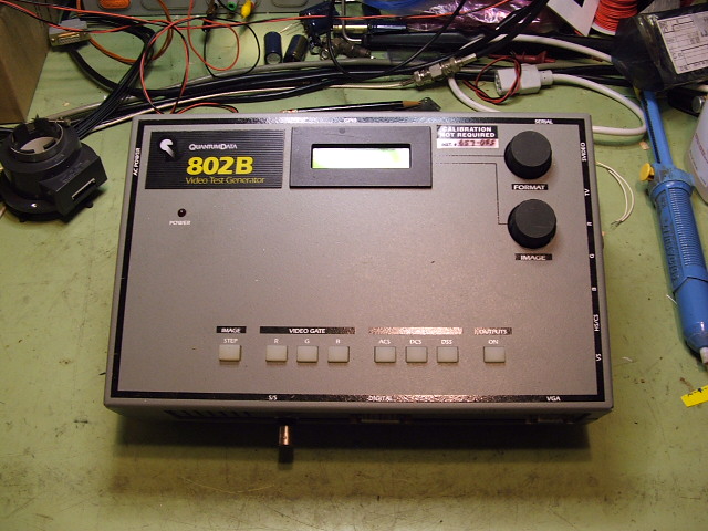

Gitcha one of these. Calibrate any format.
Scott

Posted: Fri Nov 27, 2009 3:04 am    Post subject:
Oh great. I think you can get those at the local Radio Shack Laughing
