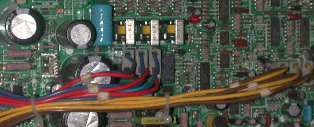

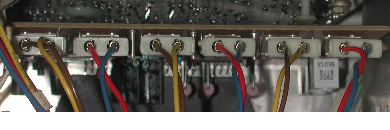

Ok, here are the pics of the boards. My camera is a pos and I can't get it to change shutter speeds from 1/60 sec, so it picks up only the raster scan and no the whole image on he tube face....ugh!
Describing what is on the tube face.... when I go into a menu, I can read it just fine. The top and bottom are bowed inward. It also does this on the test paterns and affects those patterns since they use the whole area that you have set for your raster.
I tried the plug combination (C board) that was on the label on the inside lid for front desktop. I did it using the component side as a reference and also the back of the board as a reference (left to right reading the colors). The way that it is drawn in the diagram, it seems to be with the back of the projector as the reference so I wasn't sure about that.
I saw in a post that curt replied to over on AVS where he told a guy to reverse the yellow/brown on the C board which is what I have done here in the pics that I posted but I am still having the same issue.
I'm seriously hoping that I don't have a bad board and that it's just a matter of "operator head space" here.

Elaine Benes
Joined: 25 Apr 2006
Posts: 1416
Posted: Tue Dec 22, 2009 2:50 am    Post subject:
Funny how things work out, eh ?
I just yesterday evening sold my PG Xtra that has been in the garage for over a year...otherwise, I'd just head out there now with a printout of your plug orientation picture to confirm them...Hopefully someone else who still has an Xtra in their possession can confirm your orientation. Sorry...
Just some more info, you *should* be able to confirm your plug orientation is correct by looking directly on the board that they plug into, there is both the actual designation for each plug eg. AG, BG, etc, and the pin number printed right on the board so you can get the orientation unquestionably correct.

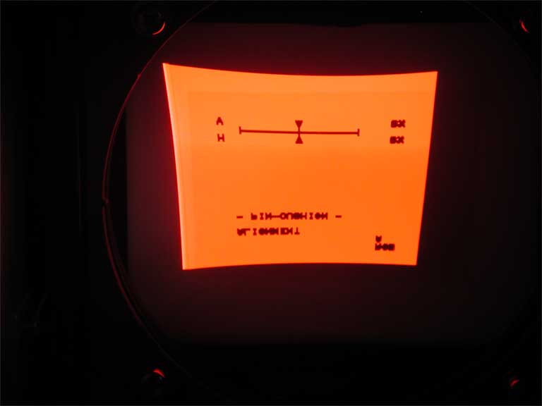

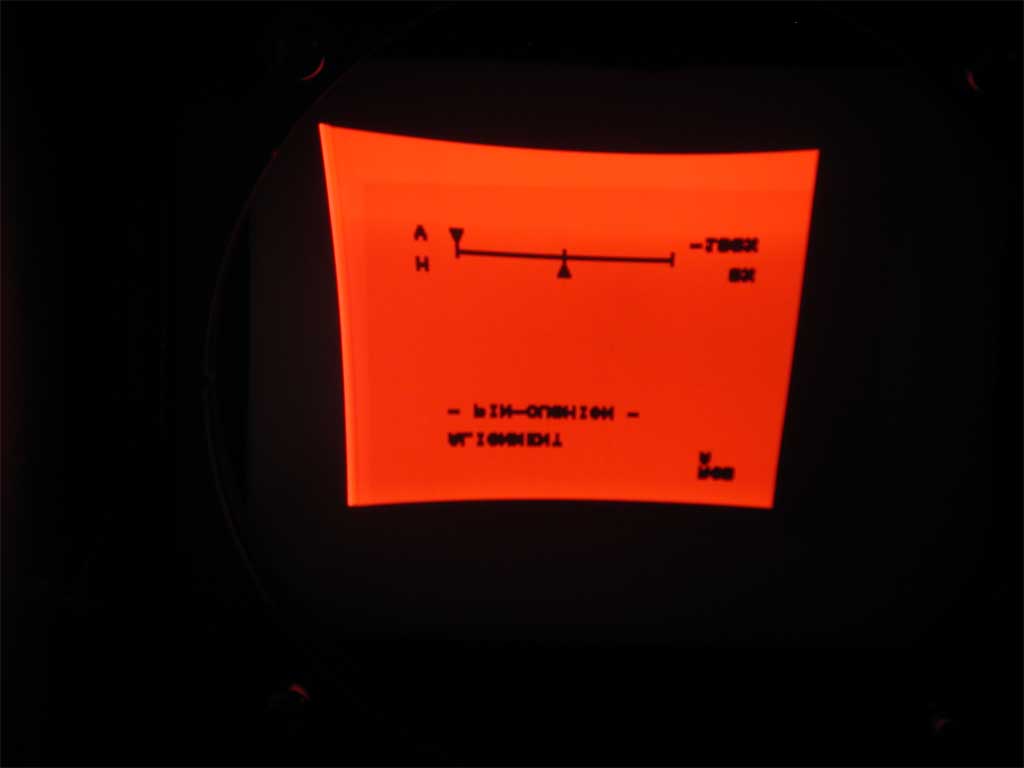

I figured out what you were talking about concerning the orientation and now have it correct. The brown/yellow on the C board were backward. I corrected that but still have the same issue with top/bottom bowing. I have pics of the screen faces that I will need to get off of the camera and will upload them asap. I can move the vertical pin cushion to either extreme and still no movement to remove the bowing of any of the tube faces?
Horizontal movement works perfectly.
Would I start looking at the stk pack at the bottom of the C board next? As long as the part is available, replacing the part isn't really an issue for me if that is the most likely suspect in this case.
Below are the pics that I took of the red crt face (all other crt faces looked the same). As you can see, no change once the vertical pin cushion is changed.

Yes, starting off by replacing the STK392-040 chips is the usual tack, I think, I had to do it on one PG I had long ago ....
Got the chips from some place in Georgia...mmmm...Georgia Audio Labs maybe ?
