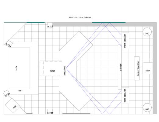

Posted: Fri Nov 13, 2009 6:14 pm    Post subject:
SC - don't worry about raining on my parade - i appreciate the input. really Smile
the screen size is unfortunately unchangeable. my room is 13 feet (156 inches) wide, and the speakers are 20" wide. so, that brings the width down from 156 to 116 inches. I want at least 18" on outside wall of the speakers so that brings it down to 80" for the screen. add in a few inches on either side for the screen border and bingo - 72 inches. sigh.
i looked at putting the screen on the back wall, or at least closer to the back wall, and the speakers (which are also 5 freaking feet tall before the stands) get in the way of the screen. the center chair gets a great view, but anyone on the sides gets a fair chunk of screen lost to speaker blockage.
I sit about 8.5 feet from the screen. for me the ratio of about 1.2 screen widths is where I sit in a "real" theatre and that is about center of the house. If i stretch my arms out and splay my fingers, i like the screen width to span the width from one pinky finger to the other. bigger screen in the theater means that i sit further back. it give me that lost in the movie effect - like the opening of Star Wars (when there was only one of them) The city in Blade Runner. New Zealand in "An Affair To Remember".
So, what I'm hearing is that blending is right out at that small a screen. fair enough. good to know that now and good to find out the cheaper way, although Athanasios
those prices are better than what I'd feared. I've been following your blend issues with the latest TVone and from what I've read of your experiences I'm sure that they'll fix it.
I saw a stack a couple of years back and the effect was stunning. the depth of the image was incredible. really really spot on. When that second PJ was turned on, the improvement (to me) between that and non-stacked was as stunning as comparing non-stack to digital. well, maybe not that much of an in improvement but WOW.
I don't think that the screen was that much bigger than mine - maybe 80" wide or so - and yes, it was an over/under arrangement.
I don't think that I can do an Over Under and I don't want a big lump of mass on the floor between me and the speakers. I've tried that and it messed up the two channel listening setup.
i've attached a pic of the planned layout. the sectional is probably not going to be in the final layout.

Posted: Fri Nov 13, 2009 6:31 pm    Post subject:
Why not go with an acoustically transparent screen, then the speakers would not limit your screen width.
Chris.

Posted: Fri Nov 13, 2009 6:41 pm    Post subject:
where were you when i bought my screen Smile
seriously, i would if i could have afforded it, but i just couldn't afford an acoustically transparent tab tensioned electric screen that was in the budget at the time.

Posted: Fri Nov 13, 2009 8:59 pm    Post subject:
Zaphod,
Why the tab-tensioned roll-down? Is this not a dedicated space?

Posted: Fri Nov 13, 2009 9:30 pm    Post subject:
it's a shared space with 2 channel music. a hard match at best. it's also a shared space with my wife, and if i've learned only one thing this past year of marriage, it's "listen to your wife, she's probably right". Smile
actually she's really good about the theater, but the 2 channel really isn't as forgiving to the theatre. take a look at the room layout i posted. the width of the speakers means that a fixed screen on the wall would look great to the center seat, but anyone off center would have part of the screen blocked by a speaker. and i really like those speakers Smile so the compromise is the screen *just* in front of the speakers. such is life.

Posted: Fri Nov 13, 2009 11:39 pm    Post subject:
Nash, I don't think Spanky was being negative as much as he was being a realist.
I'm a movie buff and A/V/HT enthusiast first and second, and a CRT enthusiast third. The CRT projector is in my theater because it got me the very best PQ at the price I could afford. Personally, I love the idea of a balls-out blend or stack. Going to Cliff's and seeing the triple-stack was pure Nirvana me, and really scratches the "equipment enthusiast" itch. But (and this is a big but), there's no way in hell I'd do a stack or blend in my theater. I don't want the heat, the noise, the aesthetic impact, the complexity, or the expense. But, that's all given my current situation.
If I was single, had more of "mad scientist" lab setup in my basement, then I might be playing around with a blend. Wink
Zaphod, I get it. Yeah - trying to mix a 2-ch setup and an HT setup is tough. If you weren't so hardcore on your 2-ch listening, a fixed AT screen would let you keep your speakers, but put everything behind the screen, and probably gain a little floor space in the process. But, obviously, you don't want an AT screen in front of your 2-ch setup. It's a dilemma.... But, seriously, with your screen, and given that you're an audio guy, I don't see a stack or blend making sense in your setup.

Posted: Fri Nov 13, 2009 11:54 pm    Post subject:
yeah, i'm quickly coming to that conclusion too. man, i wish i wasn't a gear head sometimes. it hurts to pass on such a great projector.

Posted: Sat Nov 14, 2009 12:21 am    Post subject:
Seymour AV has really nice AT retractable screens.
http://www.seymourav.com/screensretractable.asp
Their AT fixed screen DIY material looks very decent too.
http://www.seymourav.com/screensfixed.asp
