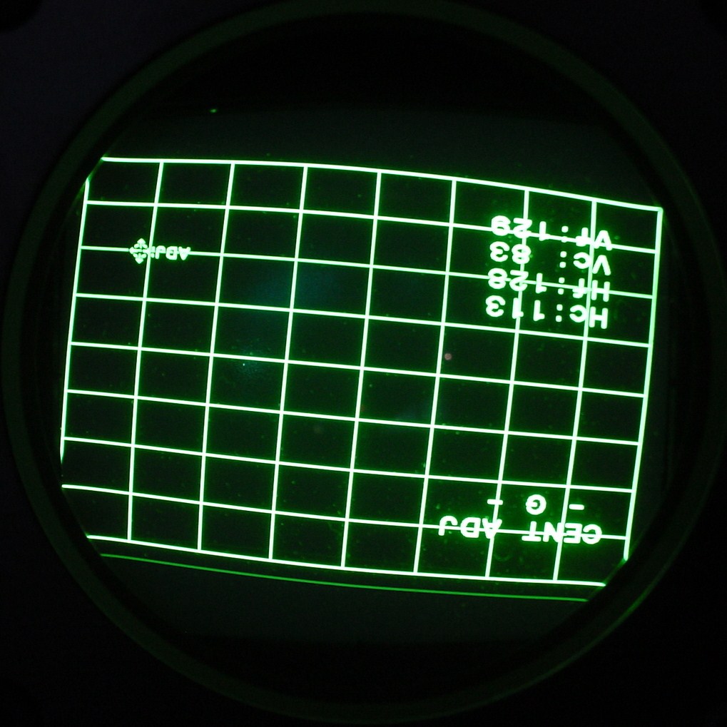

The inside of the tube is at 32,000v (or thereabouts, not sure about a Sony), the outside of the tube is grounded. But I still wouldn't touch it.
The G70 coils are reasonably well protected, only the deflection coil is exposed I think. Which is the one you want to turn..
Have the coil pre-loosened, turn it with the plastic housing till the raster is level, then tighten the clamp.

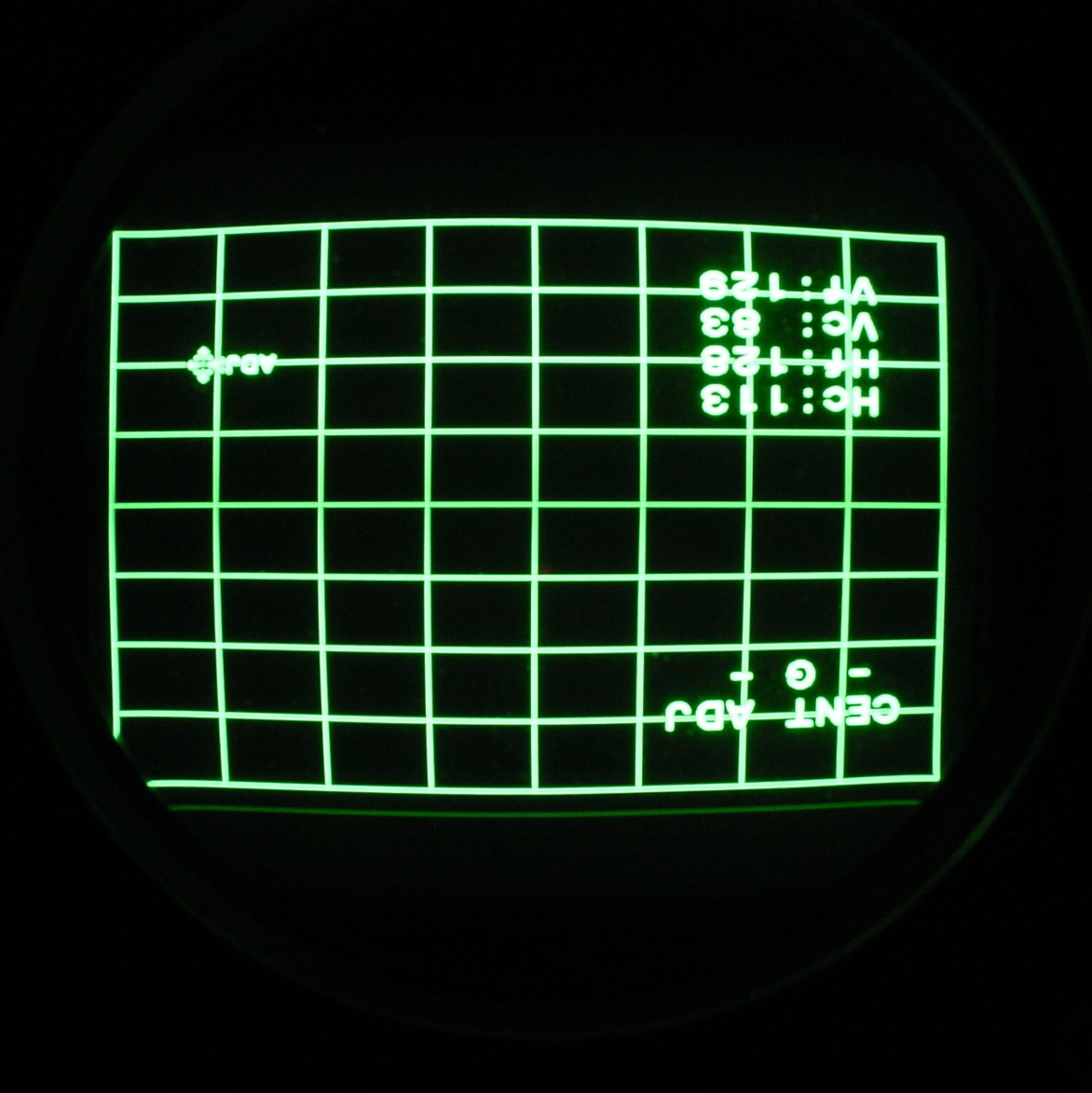

Thanks Mark, That was the notion I was trying to confirm from what i've read so far. I just found a link for the service manual so i'll read through it before I start the adjustment. I think this should be all I need to do. When I pull up the grid pattern it looks like an exact match to the old tube, including focus and astig (except for the tilt). Smile Here is a Pic:

Alas, I spent my whole afternoon yesterday just to make sure turning the deflection coil was the correct thing to do, but it all worked out. The Raster was almost identical to the old one after adjustment. My girlfriend had the pressure on to watch The Simpsons so I did not go through all the procedures outlined in the service manual yet. I just recentered the image and adjusted a few geometry settings and 10 minutes later i had a watchable image... with no tube wear. Here is a pic of the newly leveled raster:
I'll post a few before and after screen shots this afternoon. You may laugh when you see how slight the wear was. I went through a lot of trouble for this, but I guess my projector is as close to perfect as i could ask...

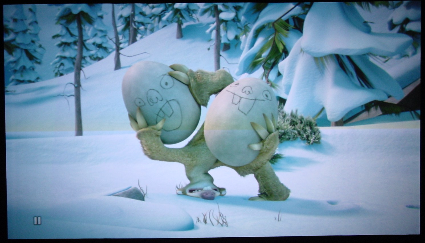

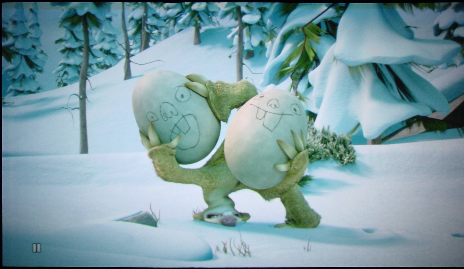

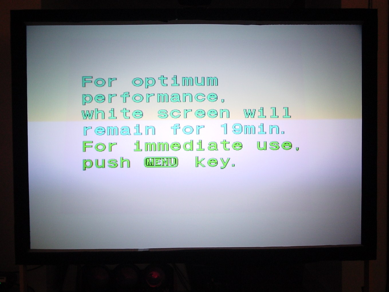

Here are the before and after photos. I'm still figuring out screen photography, so there is a heavy darkening on the top half of some of the pics which is solely camera artifact, not part of the original image.
Pictures are as follows:
1- original tube. can you see the wear? if not check #3 for a clue.
2- new tube. picture isn't dialed in yet, but no wear.
3- full white startup screen with old tube. tilt your screen back and the wear pattern in the shape of a pink keystone is fairly evident.
The camera doesn't show the wear as good as my eyes see it in person, but it's not too far off.
