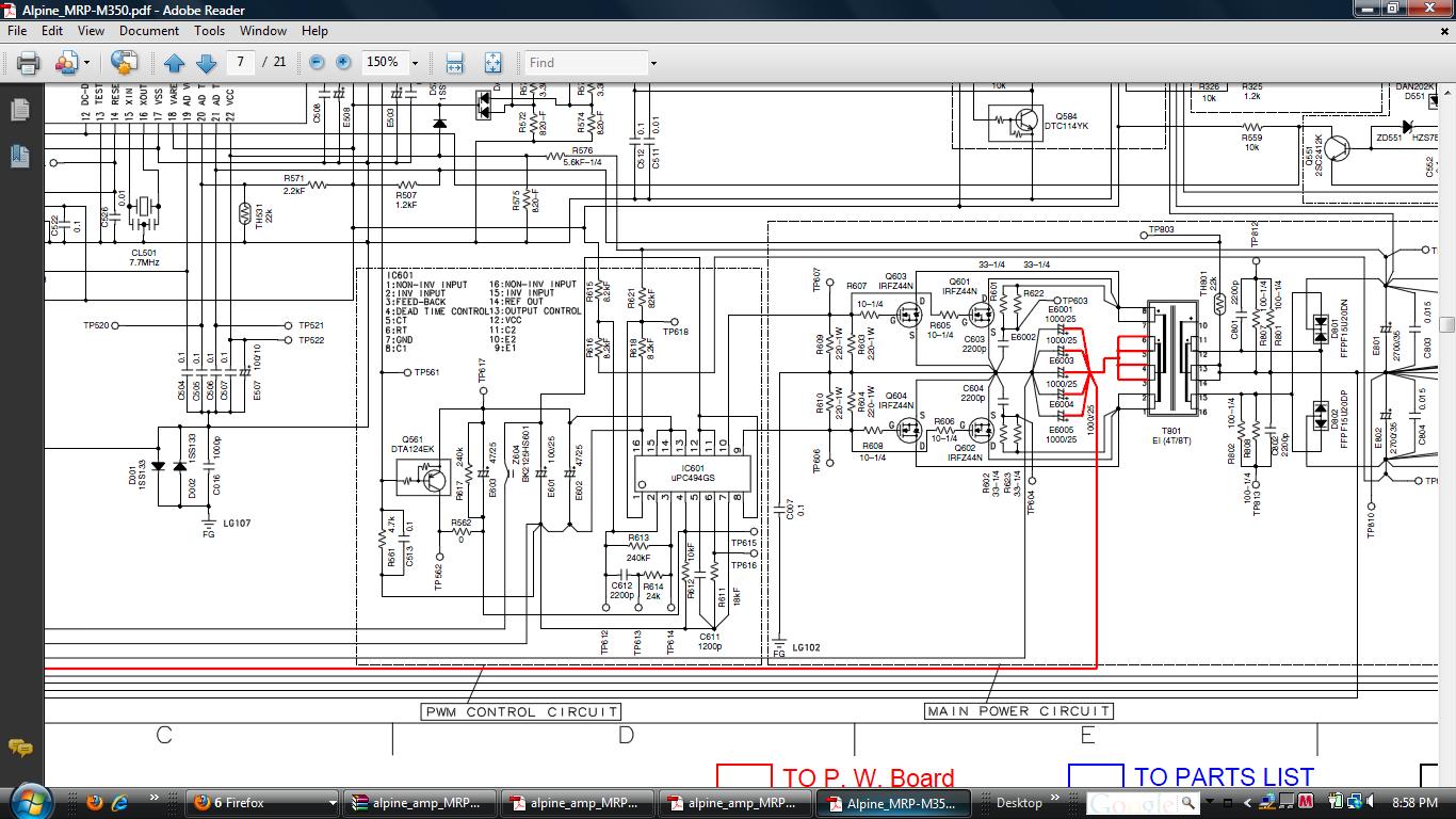

Whats the model number of that car amp your working on. I do have a source for some alpine service manuals. Mr. Green

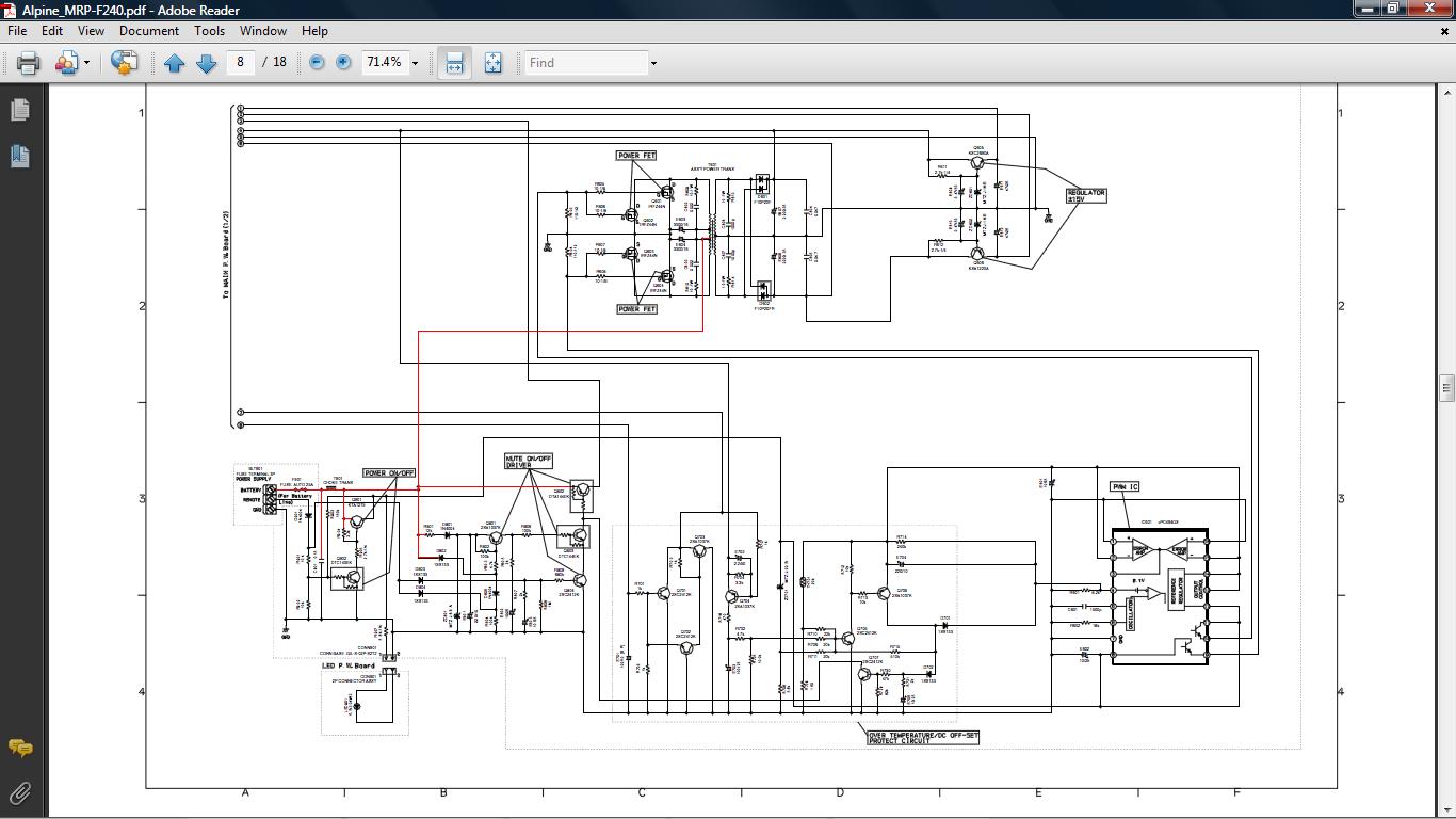

Here's a gift for you... Very Happy
Its not your exact model but give me yours anyways and I'll see if I can get it.

It's out of the V12 series. mrv-f343
The above should be pretty close...

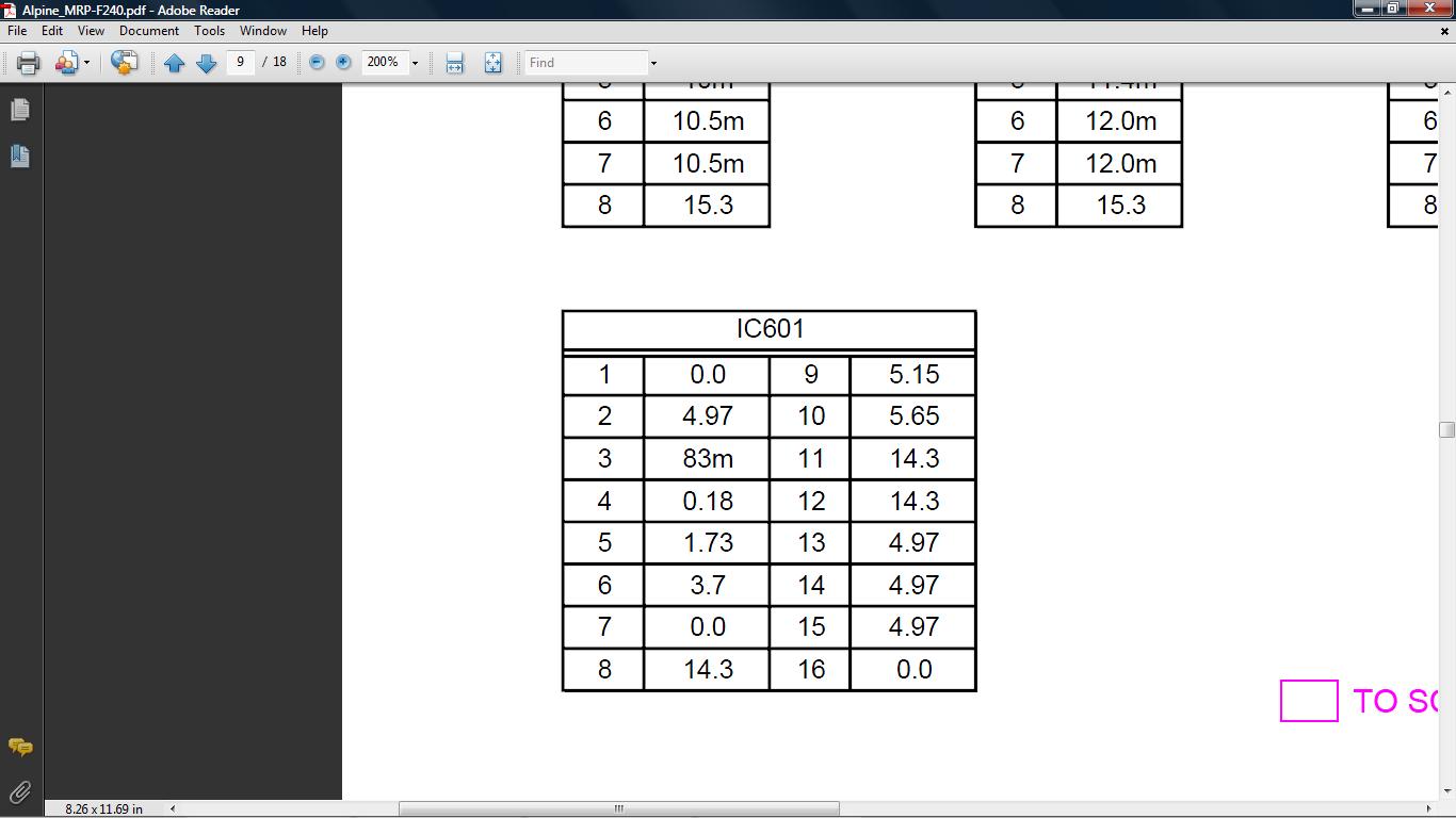

Figures that one wasn't there. Here's another model just in case. The pinout voltage one should be valid. Check that B+ on pin 12. If its high look in the voltage feed. If its low then you will have to disconnect other legs until it comes back up.
 Filesize:  85.19 KB
 Viewed:  5443 Time(s)
 Filesize:  122.93 KB
 Viewed:  5442 Time(s)

Hey, I pulled a MRV-F400 which is probably a match to yours but its a poor scan. If you want I can post the whole thing here. Its only 3 pages and 435kb. Let me know.
