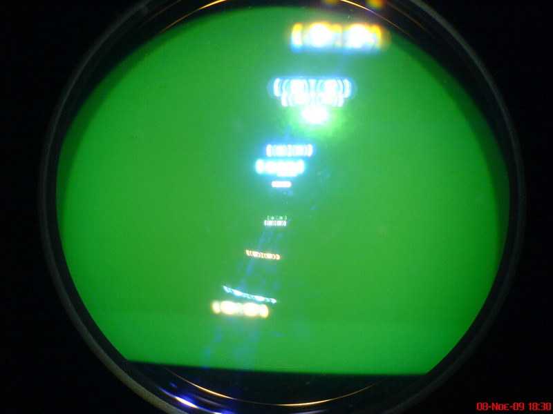

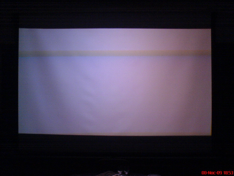

Posted: Sun Nov 08, 2009 6:59 pm    Post subject: burn tubes or?
My screen in white color from left to right, from the middle to right, come get brown!
because of 10000 hours? can i fix this or correct some how? by calibration the grayscale or colors?
Screen is DALITE VIDEO SPECTRA 1.5 gain 120'' video format! 10 years old!
The PJ is G70!

Colour shift from a high gain screen?
Is your screen really all wrinkled?
Posted: Sun Nov 08, 2009 10:27 pm    Post subject:

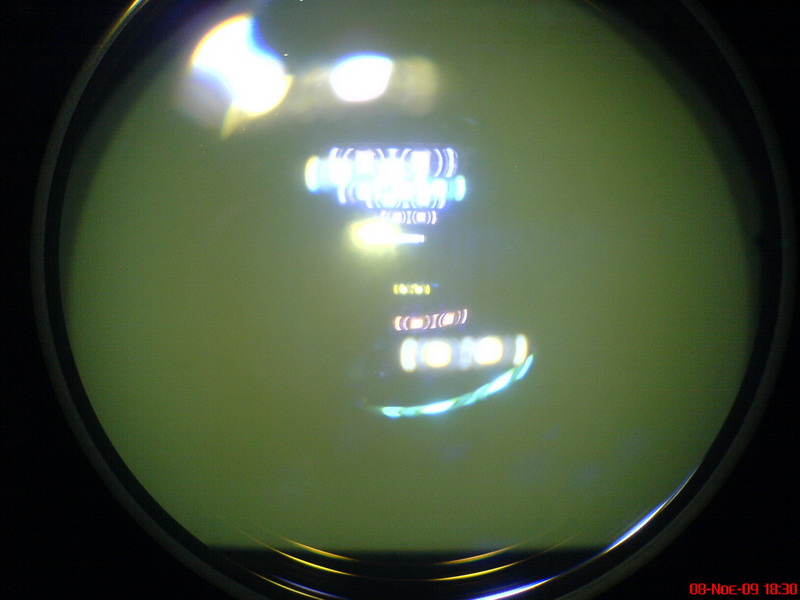

Pull the lenses and look at the tubes. The G70 does have color uniformity, you might want to try messing with it.

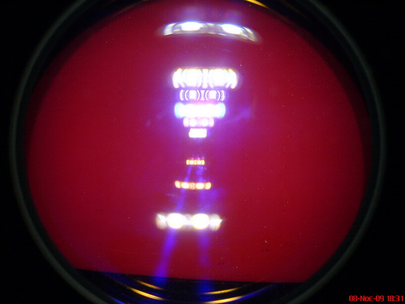

The burn on your green and blue are easily seen, I'd bet your red is burned too, BUT, color shift on a high gain screen is completely normal.. Take Zebu Fellenz advice and try to even it out with the color uniformity controls...

<Go into the G70 service menu. Locate the "Uniformity" menu. There are options for "color uniformity" and for "brightness uniformity." Adjust these to taste and to fix the problem.>
This is it! Thank you!!!
