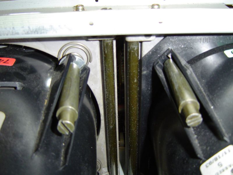

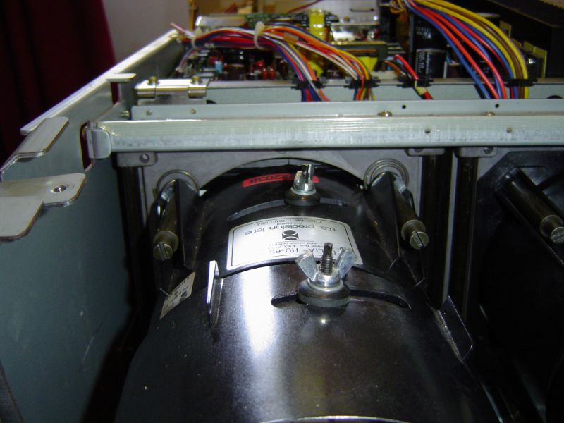

You can add flapping to a PG using cone-shaped springs (like the ones in the base of an old flashlight).
Mark,
I am interested in this. Do you have any pics of a projector with these?
wallace

wallace123456 wrote:
Mark,
wallace

Posted: Thu Nov 05, 2009 2:22 am    Post subject:
Nice. Looks easy enough. Do you have any problems with the bolts working lose? I ask as my projector is right below a busy part of our living room (lots of traffic).
wallace

Posted: Thu Nov 05, 2009 2:33 am    Post subject:
Dunno.
We played with this 6 or 7 years ago. It was never really tested long term.
But I don't think that will be an issue - they are working like spring washers.

Posted: Thu Nov 05, 2009 2:49 am    Post subject:
Conical compression spring:
http://www.grainger.com/Grainger/items/1NDJ3?cm_mmc=Google%20Base-_-Hardware-_-Supplies-_-1NDJ3
