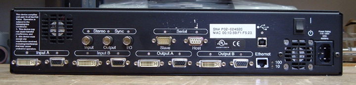

Hello
Post some pix of the back panel close enough to read the labelling; the nature of the inputs should suggest what the capabilities are.

Posted: Fri Oct 30, 2009 11:44 pm    Post subject:
pdf and pic attached

Thanks for your comments Athanasios and the links, I just wish it was that straight forward, all the parameter changes and setups are done in the control software on a seperate pc running windows 2000 then loaded via LAN to the unit, the problem is the communication link between the unit and the pc.
I have only connected the unit through one vga terminal to one pj at the moment just to display an image however the last users settings are locked in the panomakers memory all I get at the moment is distorted image.

Posted: Sat Oct 31, 2009 2:10 am    Post subject:
try using the rs 232 port instead to talk to the unit, on the Tv-Ones i can't get the lan to work either.

Posted: Sat Oct 31, 2009 3:26 am    Post subject:
ginger123456 wrote:
Hi Athanasios
I think your suggestion to try the rs232 connection will be my next step, will have to go out and purchase a cable to give it a go, many thanks.
Ginger123456
now there are two types of RS 232 cables regular and Null. not sure which one it will need so you might have to buy both. Read the manual more to see what kind it would require. Id like to see how it works also. MadMrH here and on AVforums in england uses the Tv-Ones like I do he might be able to help you out if you live nearby.
