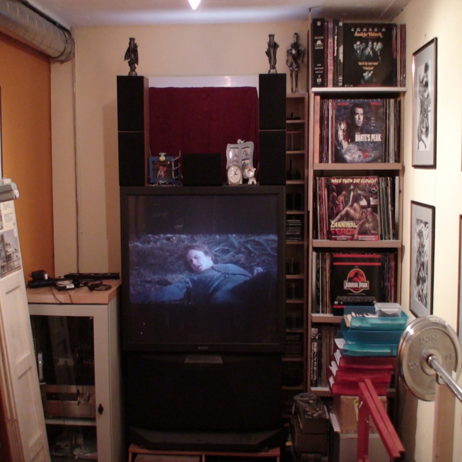

I have been watching a lot of movies of late in my Workshop while doing modifications and upgrades.
I started playing a movie, to find, a 4x3 TV just plain sucks now.
at a aspect ratio os 2.4, this movie looks so small.
Anyone know the movie?? No prizes Cool
Looks like I should get another projector rather than keep using the RPTV.
Anyone else fine the same problem??

Nice Laser disc collection Steve!!!

Thanks, there is more, but I ran out of shelf space.
I have to build the shelf which is on the left side of the pic.
The movie is from Blu-ray on the TV.
My Popcorn Hour has been one of the best investments in playing back HD movies.

Yeah, no kidding, nice LD collection. And that's in your shop? Your shop is nicer than some people's HT! Wink
Hey, why does the raster look compressed vertically? It looks like the TV is set up for a 16:9 raster squeeze, and the source is outputting 16:9 as letterboxed (i.e., looks like you're getting a double-squeeze).
The picture looks right when I vertically scale the pic 133.33%.

Oh, and I measured the image on the screen to verify, and it's right at 3:1 (not including any overscan) so it's definitely not displayed in the correct AR. It's actually 75% smaller than it should be vertically, so that confirms my "double-squeeze" theory.
I had a friend with a 4:3 Sony HD set, and I remember having trouble with getting the AR right on that set, too.

I have my Popcorn set to 4x3,
otherwise the aspect ratio is completely wrong,
This is the first movie that I have seen such a small image.
I will check tonight on my main system with the same movie to see if the aspect is correct.
