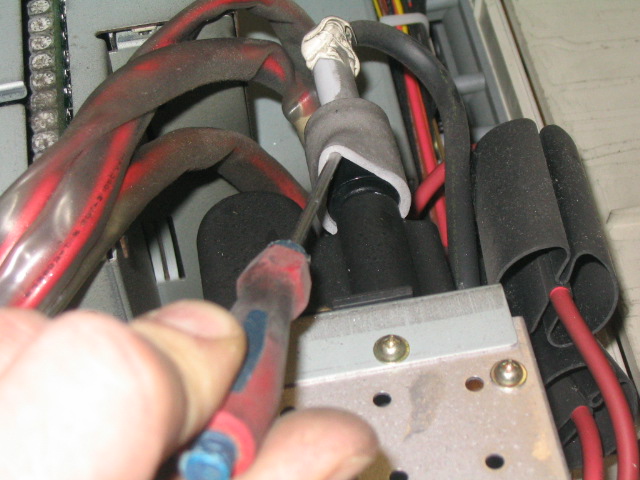

I'm changing the tubes on my 6pg xtra, and i've got the tube free, I just can't see where to remove the hv lead.

Have you read this?
http://www.curtpalme.com/NECPG_tube_replacement3.shtm

I had to undo all 3 hv leads to get the tubes out of the projector that i'm putting the new tubes into, and am unsure which lead plugs into which spot on the hv splitter. I figure green is the middle one, but not sure if red is the bottom one, or blue?

As long as the supply is in the correct receptacle the others are inter-changeable, they are equal distributions for each tube. If you prefer to have them the way they were originally, you should be able to tell which went to which simply by the way the wires fall, they're very stiff and should point to the receptacle they were removed from.

I was thinking that might be the case, but wasn't sure. That makes it a lot easier, because it's rewally difficult to remove the tubes by only unplugging one hv lead at a time.

Make sure you follow Curt's advise and slide a small screwdriver or something under the HV lead boot. There is a suction and if you are not careful, you will pull the wire right off the connector.
