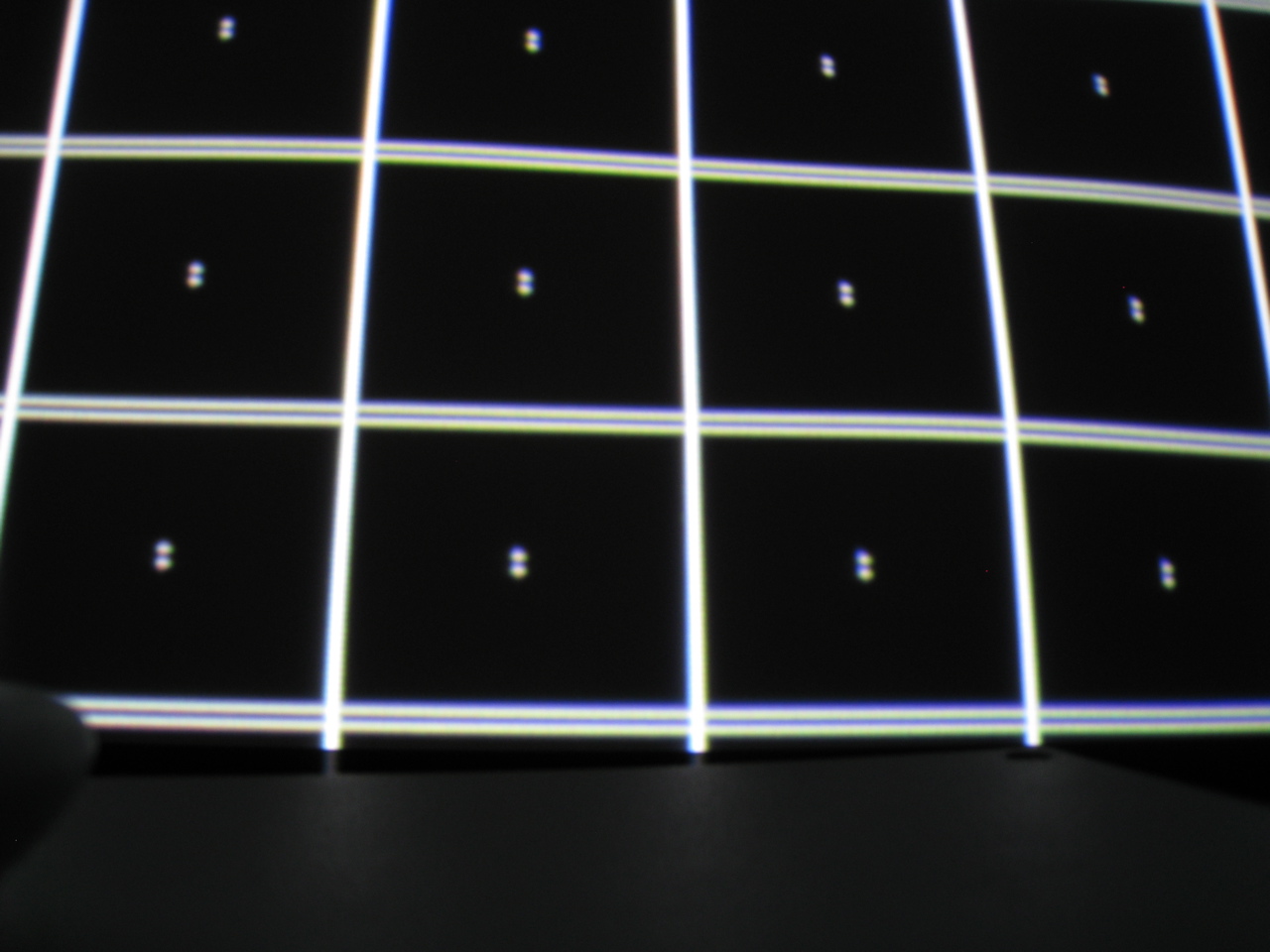

Hey all,
So I set my father up with a theater a few months ago and he's been happily using it. Today he calls me and says the projector is "fuzzy" near the bottom of the screen (ceiling mounted). After questioning and determining it's not convergence, I ask him to take a few pictures to see what he's talking about. It appears it's happening more or less over the whole screen, and it's nothing that I've seen before - apparently the PJ is still going, still displaying video (he watched Italian Job tonight), but something's obviously wrong. He says that he can see the lines oscillating, like they're wobbling up and down, forming the double line we see in the picture.
Any ideas??
TIA,
Ben

Posted: Wed Oct 21, 2009 3:37 am    Post subject:
Mine actually today was doing the same thing but on the vertical, lines, i have had it happen before and when i came back to it the next day it was gone. I think it was source or signal related. I just got home from work so I will go check mine now. and if its there i'll take a pic.
Posted: Wed Oct 21, 2009 3:47 am    Post subject:
Ok it was there when i went down, i checked the cables and I retightened my DVI output cable from the Tv-one unit and it went away. i think it was a bad Verticle sync connection so check your dads cables.

Posted: Thu Oct 22, 2009 2:01 pm    Post subject:
You nailed it. I told him to disconnect the cables and check the internal pattern again, it's rock solid. I had him plug it into his computer instead of the transcoder, that is also solid. It seems like either the cable box, component cable, or transcoder is bad - we'll keep testing, but it's definitely not the projector. Thanks!!
