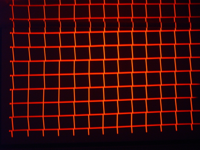

nec gone mad?!?!
97ss150
Joined: 19 Dec 2007
Posts: 161
Posted: Sat Oct 17, 2009 2:36 am    Post subject: nec gone mad?!?!
WTH is this about?
Does now ~AR

Posted: Sat Oct 17, 2009 5:37 am    Post subject:
I had a problem that looked like that. My point board was dead. Not a super common failure from what I heard, but it happens. Here was mine.
Try pulling the board and reseating it. Mine was toast. Curt replaced it. Love warranties. Thumbs Up
Hope that helps.

Posted: Sat Oct 17, 2009 6:11 am    Post subject:
Oh another thing. Pull the point board and see if problem goes away. If it does, it confirms it... Sorry watched that milkquarious video thing and I think something snapped in brain... gonna go eat some cheese...
Posted: Sat Oct 17, 2009 6:16 am    Post subject:
That is a bad point board from what I can see.
