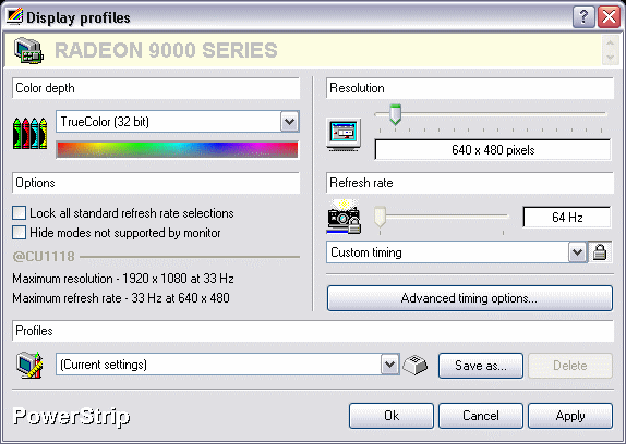

I'm at 95.904 Hz for 96 Hz which is exactly what is needed (i.e. 96 Hz / 1.001).
You need to find a balance between porches that gets you as close as possible to the desired refresh rate.
Note that the actual refresh rate will only be displayed when you double-click on the little camera icon in the attached image.
