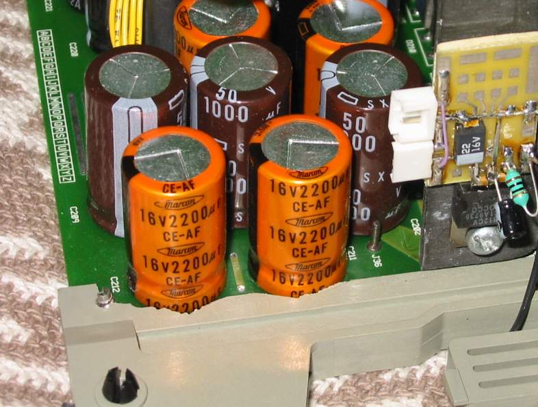

I had trouble finding the pin at first on my 1209s. It's a little different. The pin (J36) is to the right of the orange caps in this picture.

Ok, back now.
J36 is 18.26 volts.
