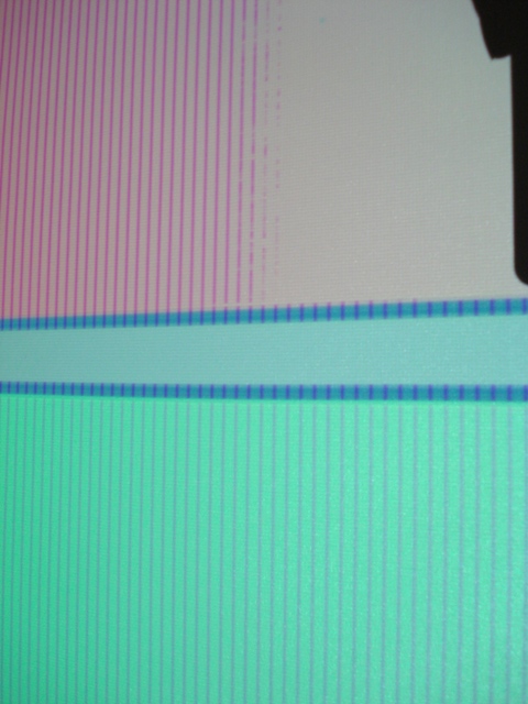

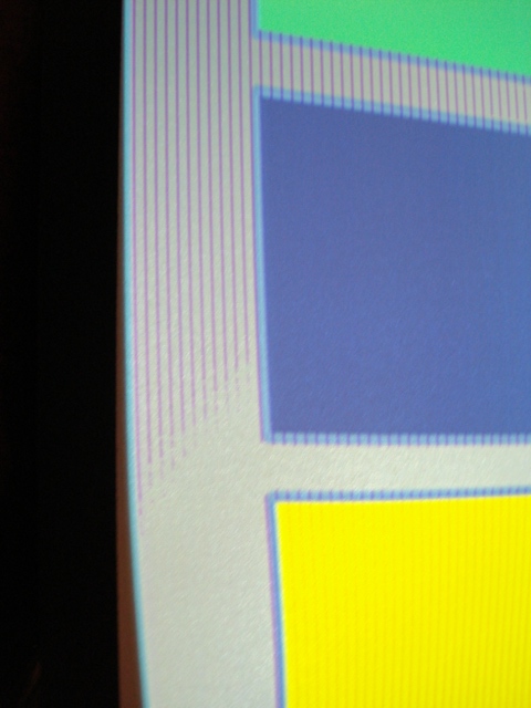

I've just got a JVC D-ILA DLA G10 projector (free) but it suffers from a series of vertical lines across the image. I am hoping it's a calibration problem, but any thoughts or suggestions would be greatly welcomed!
The lines appear to be 2 pixels wide and are separated by 3 correctly-coloured pixels. They are regular, but not constant across the full image as they seem to be sensitive to the particular shade being displayed. Certain shades display correctly, but others are corrupted with these lines. The lines are generally the colour of the image that should be displayed (but darker) but white backgrounds seem to show pale pink lines.
I have tried got the Psactrl control software (in lieu of a remote) so hopefully have the tools to make calibration changes, but none of the experience (a dangerous combination!). I'm currently using the Computer 1&2 inputs, but have not tried the AV IN or Y, PB & PR options as don't have suitable leads.
I have tried to add some images showing the lines on a shaded background - hopefully these will explain the problem better.

Zooming in, you can see how the lines start as the shade changes. Moving from dark to light, the lines appear and disappear, as though it is unable to show only a few shades of a colour correctly.
 Filesize:  97.31 KB
 Viewed:  11095 Time(s)

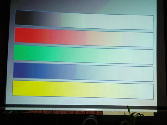

This is a quick test pattern using Powerpoint (nothing too scientific)
 Filesize:  99.91 KB

I would try another source before making any assumptions.
Posted: Sat Oct 03, 2009 7:06 pm    Post subject:
macgyver's right - definitely try a different source (or two), and try playing with the brightness, contrast, keystone, etc. controls to see if anything is inducing or exacerbating the problem.
If I were forced to guess without doing any testing, I'd put money on a failing LCoS driver or the LCoS chip itself... Unfortunately.
If you got the G10 for free, you might be able to find a cheap G10 with a dead bulb, and just move your good bulb over.

Try adjusting the phase controls. That sometimes affects banding. As the other guys have said try a different source and if possible a different input.
