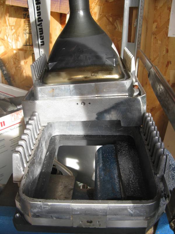

so I got this tube with the plastic covers splayed out, looked like the Alum. housing underneath was too big, which it was. I think this might have been a really old M9000 housing possibly even the ones that used Thompson tubes.
Easy fix though, get yourself a new, sharp 18 tooth x 12 inch hack-saw blade and you can easily trim it to correctly fit the newer style Plastic covers. New style housing on top, old is below with saw blade in it Very Happy

Posted: Mon Nov 30, 2009 1:59 am    Post subject:

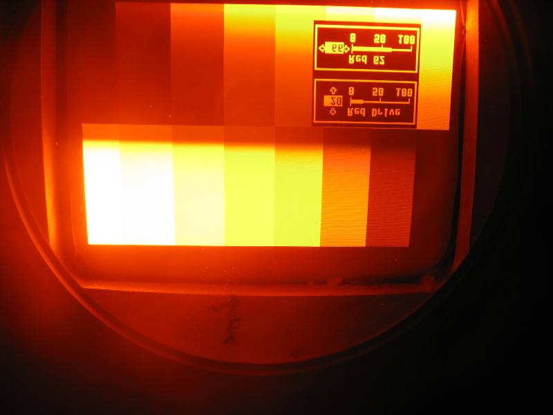

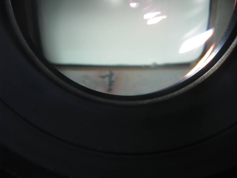

Posted: Sun Jan 31, 2010 8:31 pm    Post subject:
here's another one for the Annals of Marquee LC chamber horror story's. Got a machine in for HD mod's + bellows and while I'm going over it I find the usual stuff, glycol leak corrosion (luckily while on ceiling), old 8000 HDM, etc. Then I look into the Red tube Shocked There is a section where the anodize either failed or there was an air-pocket in the casting or whatever but there's a 1/8" x 3/8" crater eaten into the metal by the Glycol.

Posted: Sun Jan 31, 2010 8:39 pm    Post subject:
Ouch!!!! Drags, I am trying some Epoxy VHT all weather paint right now. I painted one Housing with a tube in it already and one I need to populate it with a tube.
It been one week since i painted them so it should be ready for the glycol. I will try to get to it this week. Cross your fingers. If it works i'll let you know. Other wise you should have it anodized or tell your client you need to get a new housing from Tim.
The aluminum will get eaten if not protected, so if any other LC marquee guys see this in their tubes drain them and either try the epoxy paint or have them anodized.
