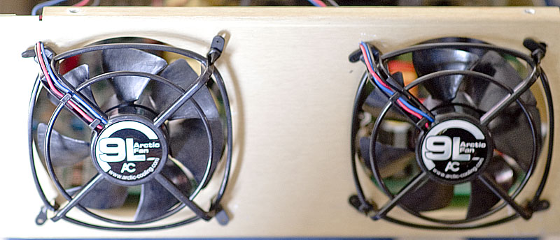

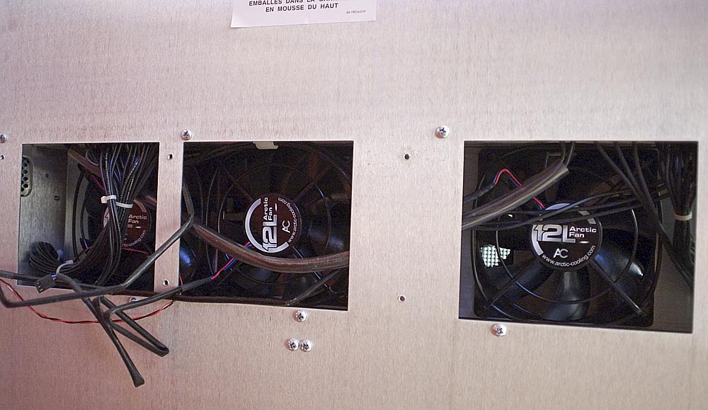

Ok, i'll work on the focus Module by installing a 4th Fan. There is not so much space left at the top.
The holes of the 3 12cm Fans are so small, i cannot understand the engineers of the M at this point.
With the original Fans (with changed LVPS Fans) the M was really noisy for me.
My experimence with "hot" hardware was good until today. My CPU and all of my PC (especially the power Supply) runs realy hot for a two years now. I don't expect 20000 Hours out of my 8500!

Posted: Fri Sep 18, 2009 5:50 pm    Post subject:
Thise fans do not have enough CFM or static pressure not a good fan for the LVPS or the bellys!!!!

Yours are only 37 CFM way to low for the LVPS and also the Belly's I think need closer to 50CFM if not mistaken maybe the mid 40's. and yours are 20 db a little louder the Original fans are the about the same, Id put them back and just use some isolation foam in the chamber and to isolate the fan from the case. do the same on the LVPS.

You think I am kidding saying "when the air comes out is not hotter than 35° it's ok ".
Posted: Fri Sep 18, 2009 5:55 pm    Post subject:
the fans in the pictures are junk. You will have soon have a broken Marquee Sad
Posted: Fri Sep 18, 2009 6:03 pm    Post subject:
measure the temp of the heat sink, who cares about the air? or measure the temp of the actual amps on the HDM and the FCM and then the back heat sink. the way the cooling system works on the marquee was a very well thought out design.
First you need enough cfm for the LVPS because it also pulls air through the HVPS, if not the HVPS could be damaged.
Second the case should be sealed, closed that is. the static pressure needs to be there, so running a marquee with out the covers on can cause certain sections to over heat
despite what seams logical.
Third the Belly fans, they are located to pull air from the sides and the back through holes near the CLM and VIM and then up through the fans which then push the air into the HDM and FCM and into the plastic covers of the tubes. The plastic covers act as a channel for the air to move back over the VNB's then the remaining air gets pushed out and over the rear heat sink that hold the CVA and VDM. that path has to stay intact and not be obstruct or caused to loose pressure, so a low pressure fan will not have enough power to get the air all the way tot he back heat sink.

But give me some more information about the 3 12cm Fans. They didn't have a air connection to anything else than the bottom hole. -> There it is, i removed the VIM and then it comes into my eyes.
My M is floorstanding.
I removed the cover of the headsink, it suitible for warm fod (oh my english, not food).
The headsink of the HDM is realy cold, like 40°C.
So ill install another fan in near to the HVPS. The cover of the necboards is not noticeable war, (i only use 1080i). And an Additional Fan for the Cards.
