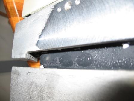

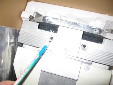

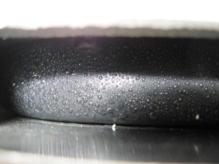

Hi guys I need your opinion. Im getting my red tube changed and this is what I saw! What do you think!

looks like you need new bellows, the silicone is saturated with moisture and glycol and I found that even if you release the presser it will sweat again but not build up pressure. its the material they used. Look into my new bellows.
