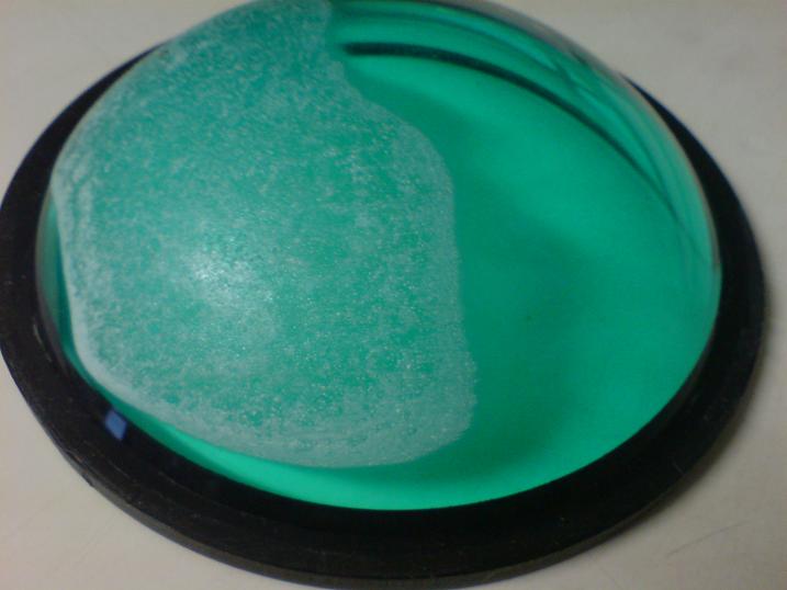

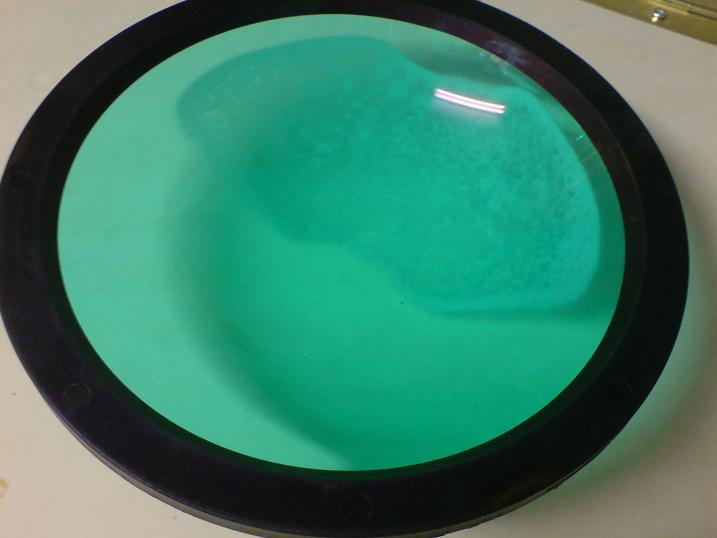

Dragamn, i think i have seen this before. I had one set 9" tubes that had something weird happen to C-elements (Probably sunlight trough lenses....) Plastic was like melted and it looked like sand grain or crystals. I think i have that C-element here somewhere. I post picture later.
Edit: pictures
Does this look similar? If it looks, its then bye bye to that C-element Sad

Posted: Wed Sep 16, 2009 9:13 pm    Post subject:
1031 wrote:
Edit: pictures
no I don't think so? I had a C-element that looked like it was starting t odo that but what I have now actually looks like particles on the surface. I will take the tube out tonight and shake it, if the stuff is loose and settles to the bottom then I will be fine with that. I'l ltry and take a pic.
