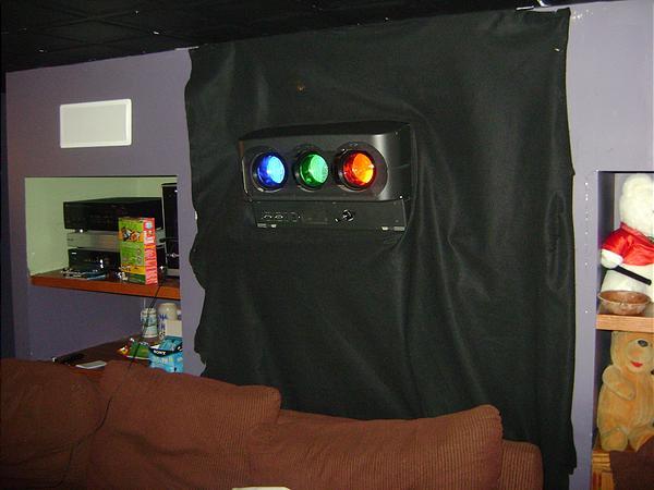

Ben here is a pic of what i am trying to say. Mr Betel I have no idea but I must be screwing something up? I
am bumbed out about the color shift but I guess it will make a good outdoor hometheater screen! Why
would da-lite say i would be fine then? Are they that hard up for money Question
this is how it's mounted

Looking at your picture I think it will work fine, you may want to put the couch on a riser though. My G70 only sits about 6" overhead, and the closer you get, the better the POP on screen. The brightness is addictive... Wink
