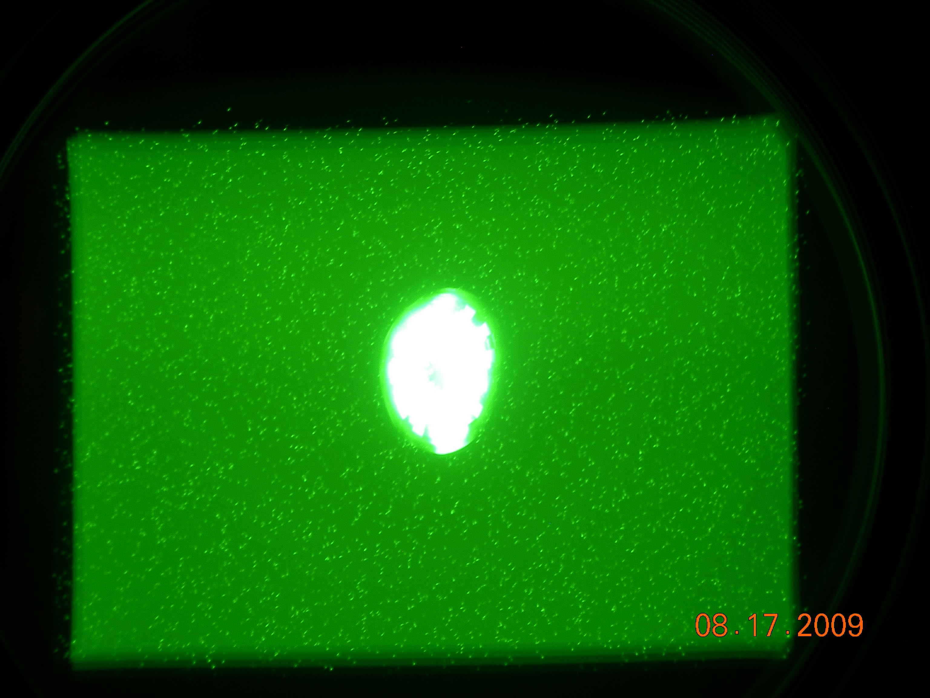

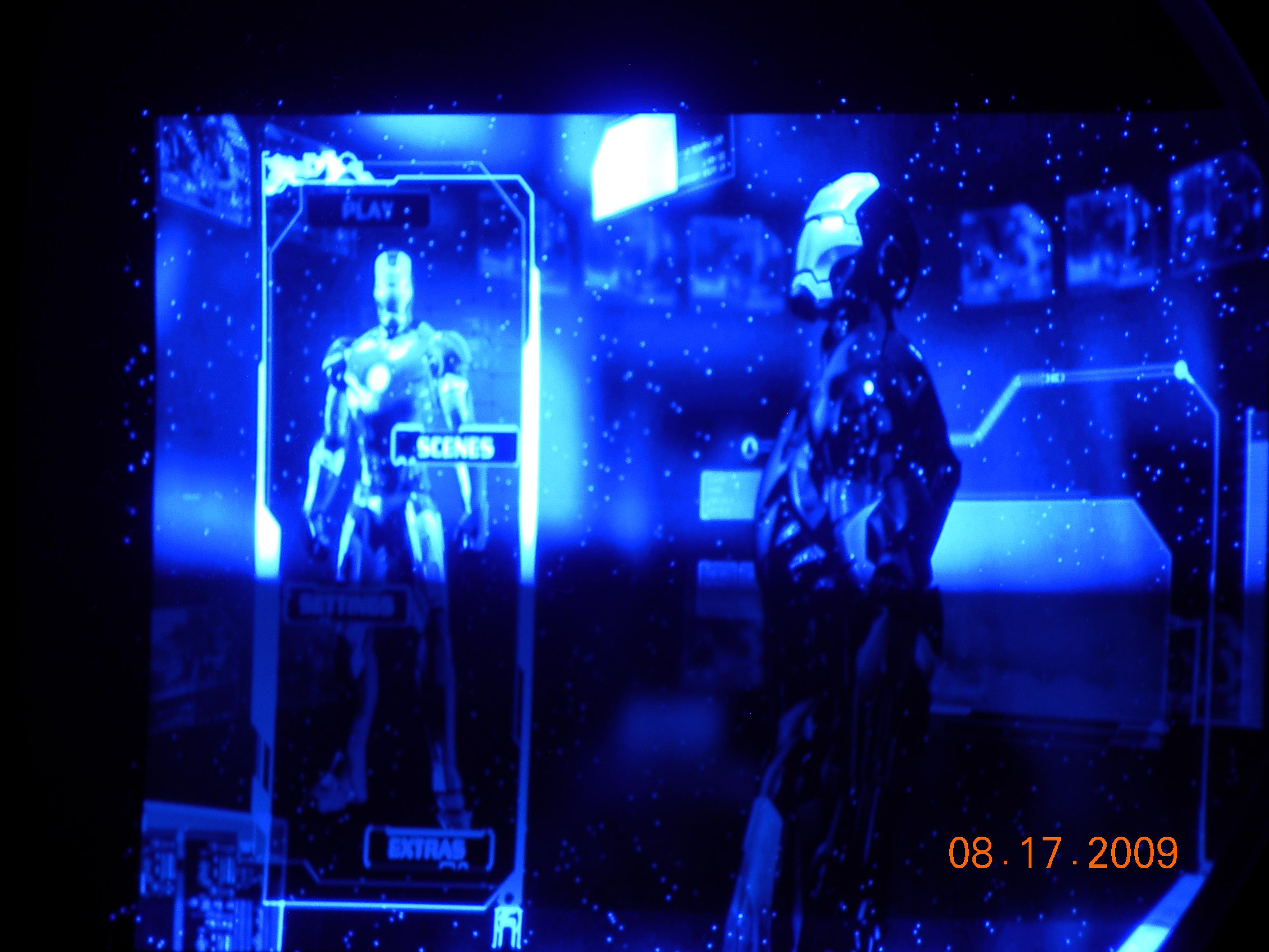

When I turn on my pj I get the snow like in the pictures. Any cue what cause this? Thanks

That Green image is troubling. If that is concentrating a spot in the cerntre it will toast the tube
do you get this with the internal pattern ?

Now that's a new problem I've never seen...... What is your source and what do you see on the Red tube ?
As Roland says the Green tube looks pretty abbynormal !

All three guns are like this. When I first turn it on is the worst. It seems as it warms up it gets less. They are pretty much equal far as the amount of snow. These images are without lens. These happen to be with my new HDFury that I received Monday. I was getting it before when driving with just the computer. Sometimes when I turn it on and it has the Logo screen the snow flickers from snow to no snow. The other day when driving with the computer there was no snow. My camera can not replicate the contrast range that the pj is putting out, thus what you see on the green image. The image was of the loading menu on Ironman, it's a pretty hot image, huge contrast. I do get the snow when I go into the adj screen and the internal pattern is there.

I'd say this is lying in the video circuits. I would look to the RGB driver board
Posted: Wed Aug 19, 2009 12:50 pm    Post subject:
It could also be SMPS or HV arcing maybe? Never seen that before.

It might be a simple problem such as HDMI-interference.
What do the internal generated patterns look like?
What does an analog source look like?

Just after turning it on I hit the adj button and I get the internal pattern with no snow. If I go to port 5 I get the snow but it is very random. I do not have port 1 & 2. It was a simulator machine no quad board. How would I feed it with a analog source?
Posted: Thu Aug 20, 2009 2:13 am    Post subject:
Get an SVGA cable to 5 BNC and use port 5 instead of the HDMI. I thought you said above you already tried the analog input with the computer? If you've only been using HDMI, then try an analog signal. I'll bet the problem is HDMI related.

Yes I did try the computer to 5 bnc and it has the snow also. It comes and goes.
Posted: Thu Aug 20, 2009 3:00 am    Post subject:
Ok, I'm guessing HV arcing somewhere. Disconnect the HV leads to the tubes one at a time from the splitter. Check the focus block HV connection from the quadrupler at the focus block. After that, you'll need to swap some boards, or send some to me for testing in a set here.
