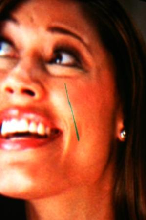

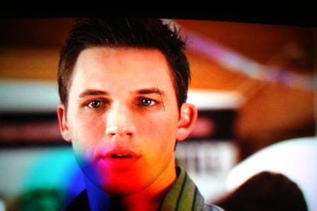

Heres a picture of the green line I was talking about. This is bothering me the most. Its flat in the middle of the screen. I watched disastermovie last night, and truely it was a disaster both the movie and the experience. Couldnt take my eyes of the green line.
Another thing i noticed is that the picture is not filling the entire screen from the top and bottom as it did before it got upgraded. I had all the setup done through a professionel so im a bit of a dork at this. At what menu exactly do i adjust that problem.

Can you see any lines on the tube face without the pj on? If so I'm afraid to say it looks like deflection burn.

Hmm. Just checked and yeah. I took a flashlight and i can see the line in the red tube. crap. I cant understand how this is possible. The tubes have run less than 1500 hours and the problem wasnt there until I switched to an upgrade and had my hvps replaced. im getting really anoyed of this whole ting

I'm very, very sorry to hear this and can understand your frustration.Is it just the red tube? If so this isn't so bad as it's the cheapest and easiest tube to source.I'm sure Curt or Drangan has a gazillion of these for a decent price.
I would however source the issue which caused this before you start replacing tubes.

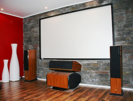

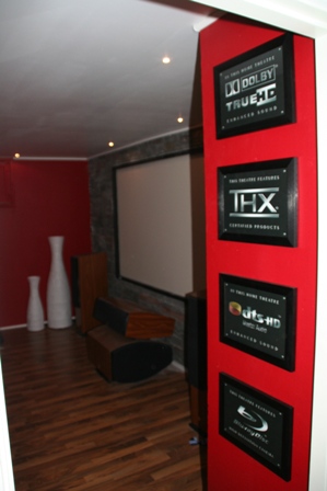

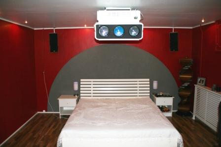

I can only see the line on the red tube. The excact same line is on the screen. Its just that im not a pro at this and ive spend almost 4 years of savings on my home cinema and its frustating that I cant enjoy my homecinema without huge expenses all the time. I wouldnt have the first clue what the source of the problem is and how to replace the tube. ive had pros install the whole thing for me and im getting tired of this crap. Last time I had a guy from another country to come and fix it for me because people in denmark arent qualified enough, at least none i have gotten a hold of.
A few pictures of my bedroom/homecinema

Wow dude.....that's an awesome bedroom/theatre setup Thumbs Up Too good to give up on IMO.
Have you spoken to Jari,he's in sweden and familiar with Marquees?

The burn you're referring to is image burn which happens( as you stated) after leaving a static image on screen for a long period of time.
This is spot/deflection burn i.e beam has collapsed into a small concentrated area leaving the line you see.
I don't know what has caused this ( not familiar with Marquees) but I'm sure the geeks/guru's here will undoubtedly has some info as to the cause.

I would closely examine all three tubes before going any further. For that line to be the shade of green shown would mean the lack of blue along with red in the same area. If it were me, I'd pull the lenses and do a real good inspection of all the tube faces.

It's really bad news with your red tube as a deflection burn like that is not repairable. IT is burned permanently into the tube. I don't know how or why that could have happened but I can say that I did run all those modules here and none of the tubes in my test machine did that. a few possible causes
1) a problem with the spot kill circuitry on the video neck board.
or
2) putting the G2 bias pin in the wrong location on the tube
or
3) Possibly a problem with the G2 circuit from the HVPS?
