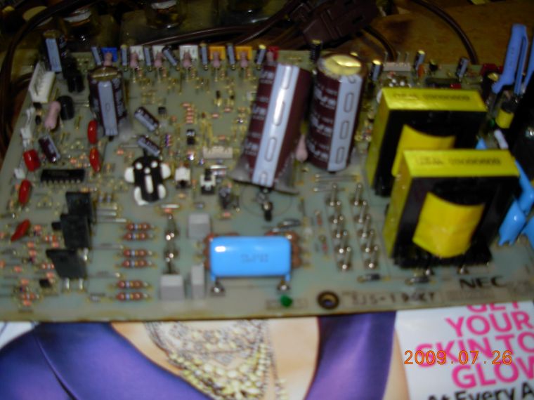

Curt I pulled the boards and noticed this. should I send both boards? Thanks Brian

Sorry what? I was distracted as my skin does not glow, and I'm quite upset. Smile
Can you solder that back into place? That could be the problem right there. If not, send it up for sure, that needs some Dr's attention. Wink

Posted: Mon Jul 27, 2009 5:14 am    Post subject:
If the capacitor leg is still attached to the capacitor...

Posted: Fri Jul 31, 2009 11:46 pm    Post subject:
Hey Curt I replaced the broken capacitor now I have error code FC. Should I send the boards we talked about. Thanks Brian
