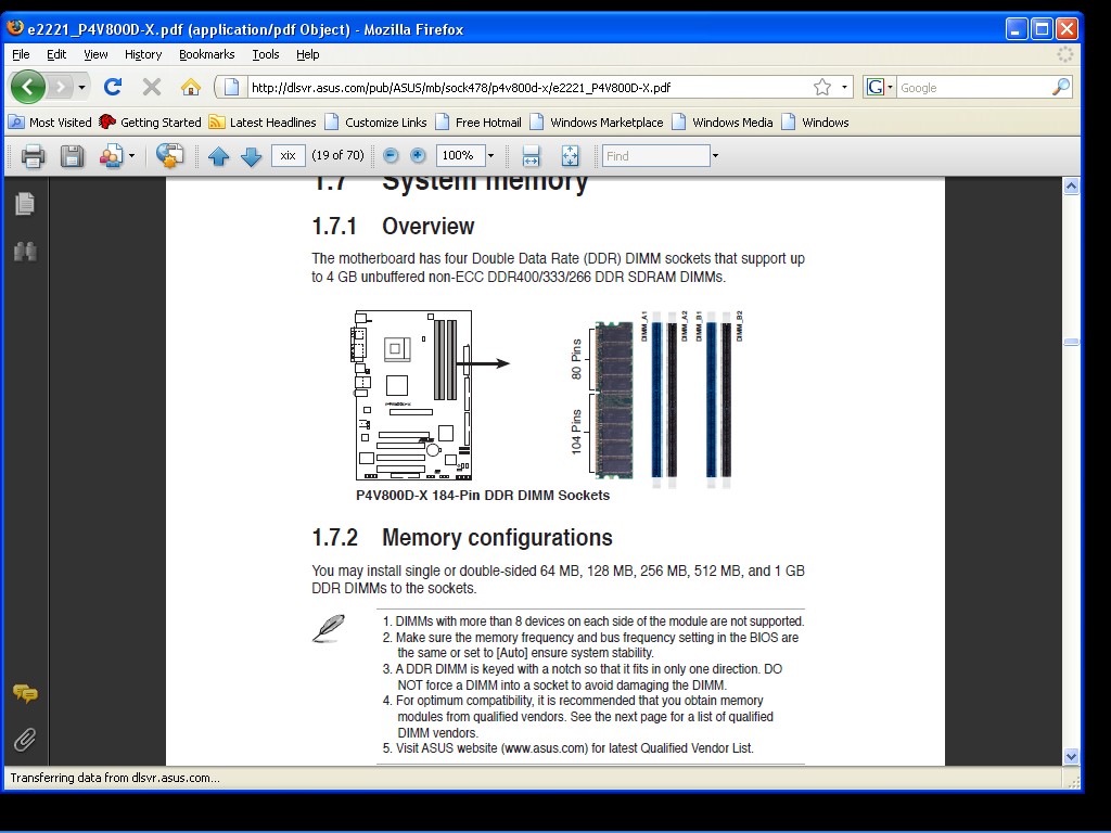

Something doesnt sound right there...DDR2 is 240pin and your mobo accepts DDR which is 184 pin?
At least that is what google tells me.
Posted: Fri Jul 24, 2009 4:10 am    Post subject:
Note 1 an 2 on page.
 Filesize:  169.86 KB
 Viewed:  2969 Time(s)

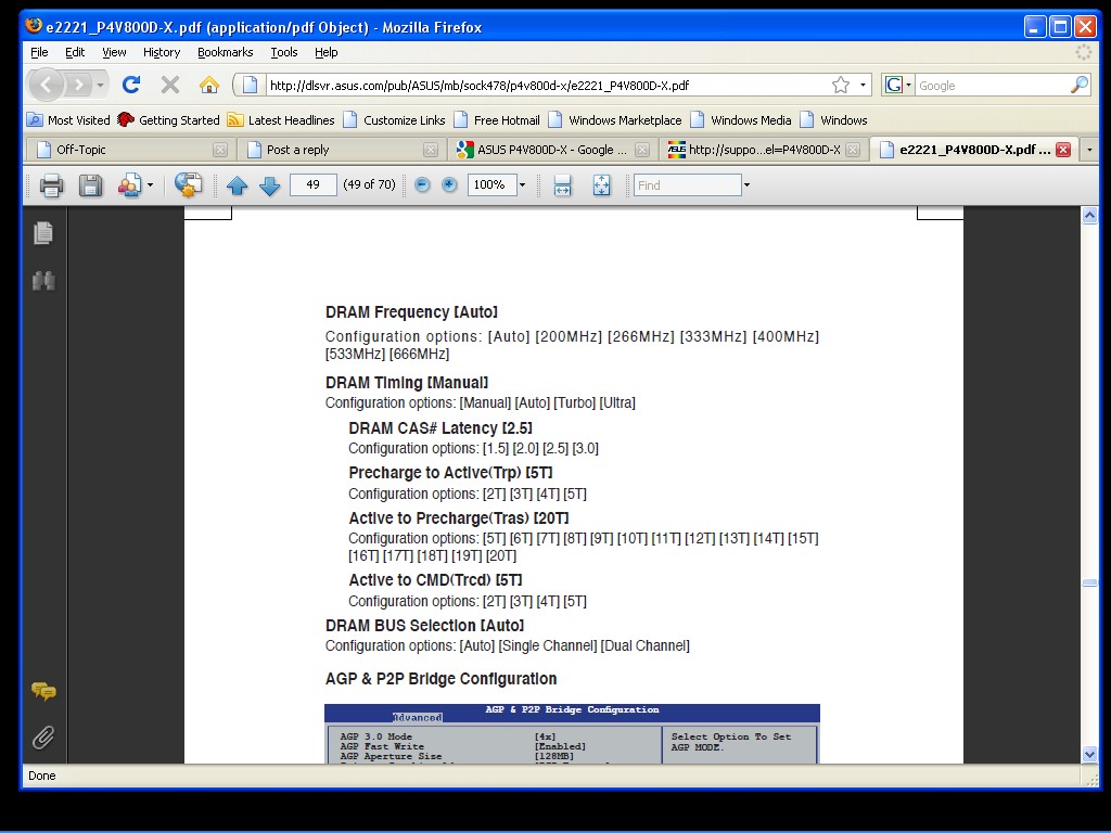

Posted: Fri Jul 24, 2009 4:20 am    Post subject:
Also note:
 Filesize:  162.69 KB
 Viewed:  2965 Time(s)
