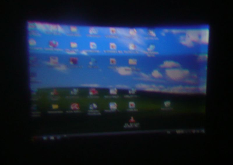

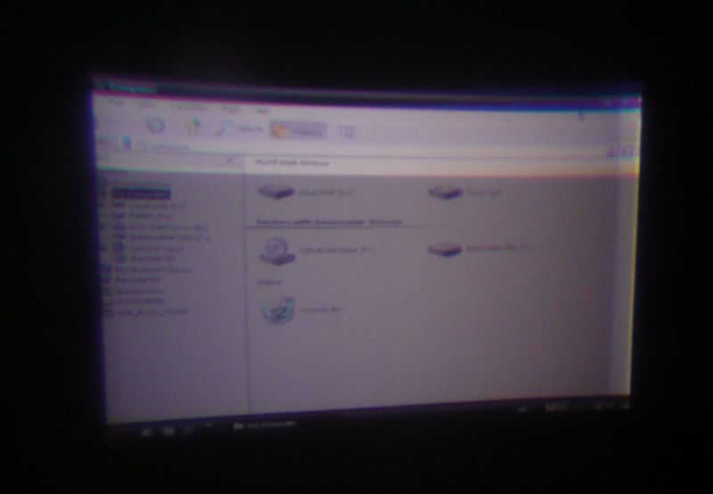

First problem is, that the test pattern most of the time doesn't get a horizontal sync, it's running left right all the time.
but when i drive the projector via rgb 576i the sync is ok, but i can't switch to test pattern ^^
second on more important problem is that the picture is very dark in 2/3. see here:
anyone has an idea which board can cause this problem ?
and don't wonder about the bad sharpness, the convergence is setup very bad at the moment, i'll do it perfect if the projector works correctly ... i think for watching dvd's the set can perform quiet good enough.

Posted: Thu Jul 23, 2009 4:14 pm    Post subject:
Check the board that sits vertically under the top cover between the tubes. Clean the module contacts.
I've got a few parts/boards for this set that you can have at no charge, just cover shipping.
It might be $50 or so to ship the boards, but you are one of the last people running the 600/722. Smile Let me know if you want them.

Posted: Thu Jul 23, 2009 8:11 pm    Post subject:
already cleaned the module contacts and checked the boards but they looked good. maybe i'm going to resolder them or change the caps but that would cost a lot of time.
thanks for the offer curt but if got one german buddie who's going to sell me the complete electronics of a 722 with broken powersupply for 10€ + 10€ shipping. if i don't find the error i'll take it from him.
other question, the projector uses TAC3 lenses now, would HD6 enhance the sharpness significantly ?
next thing to do is to solder my sync stripper to connect a Scart DVD Player via RGBHV, to get max. input quality.
