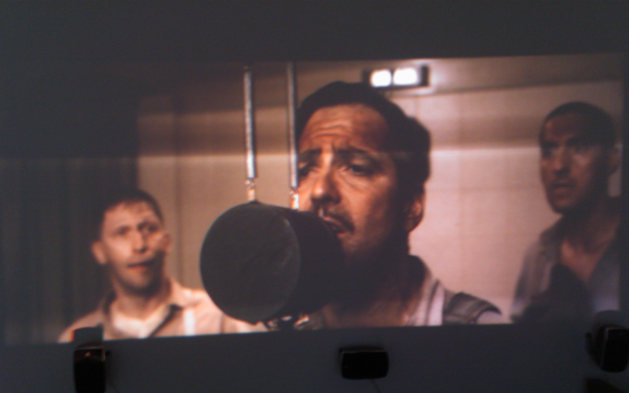

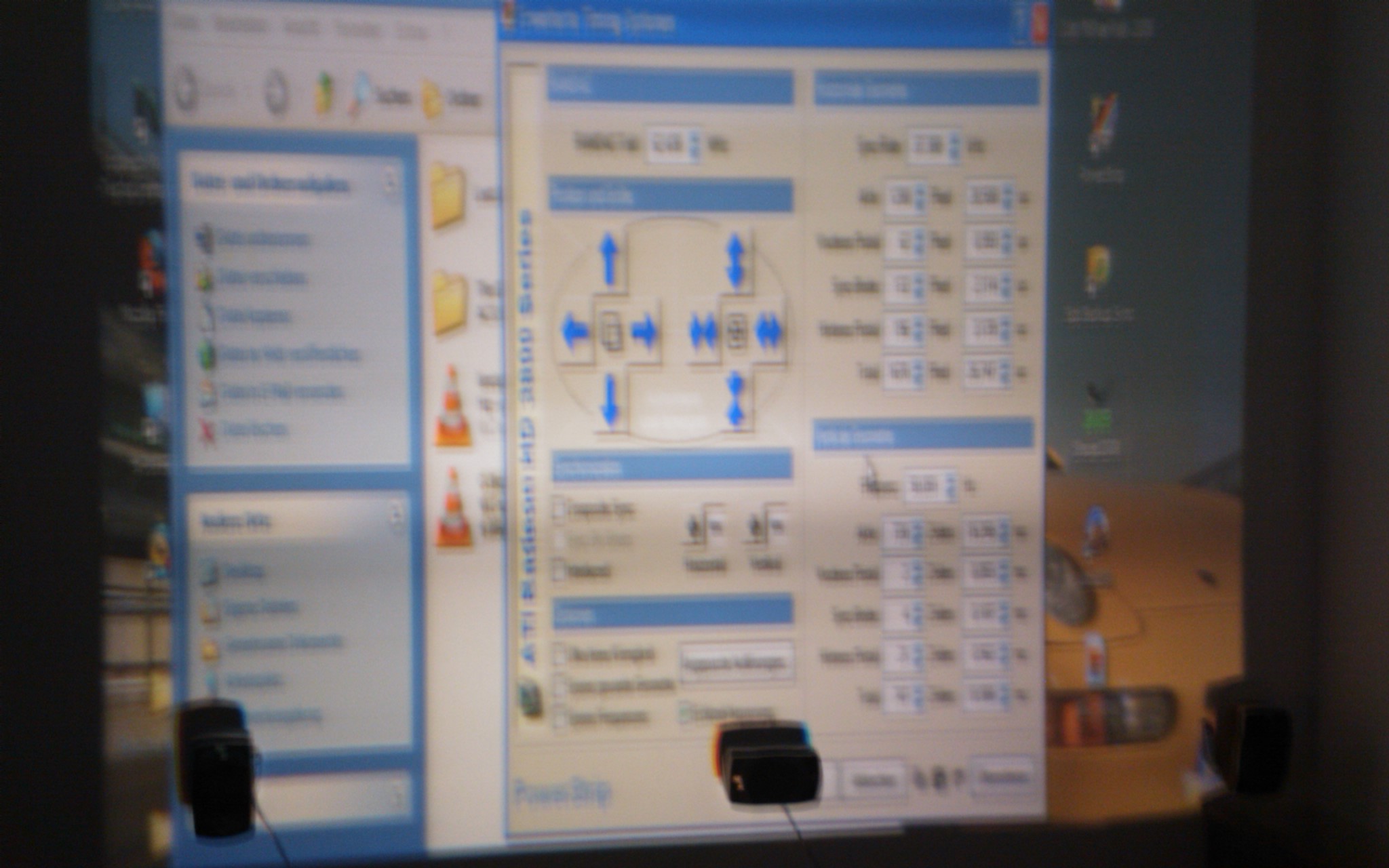

Im totally new in CRT projectors, bought a 1270 a few weeks ago. Everything works perfect, except I have one problem:
I have 2 horizontal lines on my projection. I feed the CRT via HTPC with 1280x720p @ 50Hz. The two lines move depending on Hz. At 50Hz the two lines nearly dont move. If I look in the lenses I see the lines on every tube. In the internal test rasters the two lines dont appear.
On the two attached pics you can hardly see the lines, in reality they are quite "sharp" with a shadow behind them.
What could that be?

On the pictures I can hardly see the lines, can you catch a sharper image?
How does your signal chain look like? It could be a problem of the
projector input card, which one do you use?

That to me looks like 60hz hum... are you using decent cables going from source to projector?
Ben

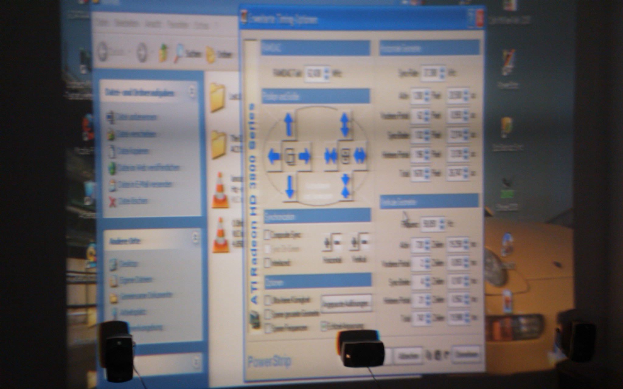

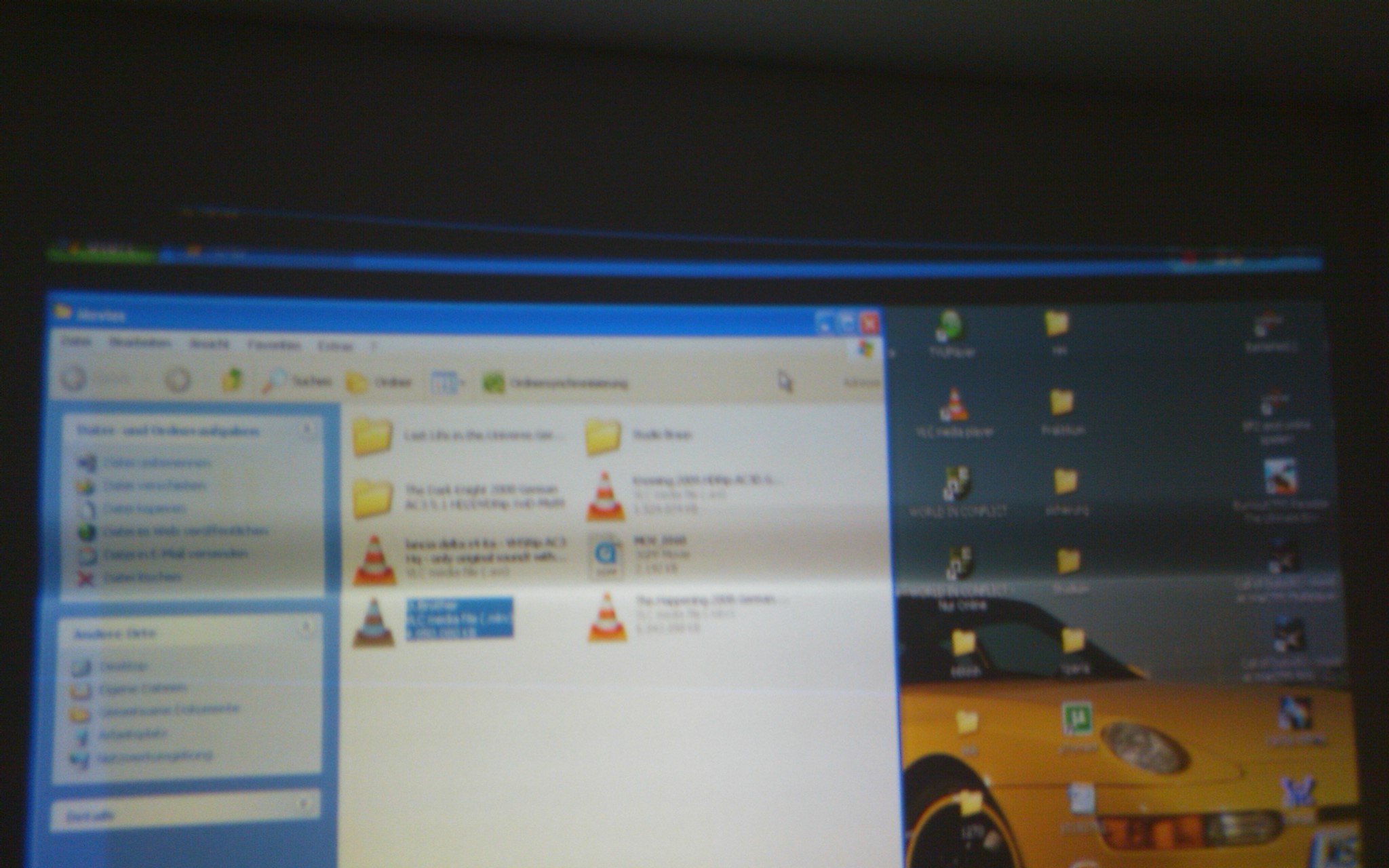

2 more pics, first one shows the line quite well. Now I also saw that the picture is somehow "cuttet", see 2nd pic.
I use a IFB-20 input card (9 pin DSub) connected to my HTPC via VGA cable. Cable quality is quite good. If I connect my satellite receiver via composite video I also get these lines, but much less intensive.

Go into your Sony's service menu and see if there's a clamp setting.
Do the lines scroll up the screen slowly?

Clamp setting is set to Auto, other clamp settings -> lines are still there.
Yes the lines scroll up the screen, at 50Hz they nearly stand still.

Those hum bars are usually induced from power. A bad power supply can cause it but since its not there with internal test patterns then its not that.
Another thing that can cause it is some what of a ground loop. I asked what power you have because here, with 110/120 volt system you can sometimes isolate it by using 3 prong to 2 prong adapters. I'm not sure how you could try this on 220/240. You would also have to alleviate anything hooked to the PC that uses A/C power.
Also are you using dual monitor setup in your configuration?
Also try a different source other then PC?
Other wise possibly something in the input card. Do you have more then 1 input card to try?

Im happy!
Just plugged the power cable of the projector in another socket (at the other side of the room) and the lines are gone!!!
Thanks a lot for your help !
