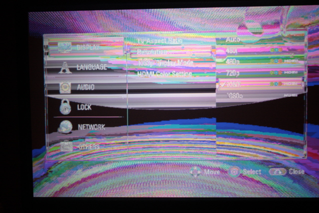

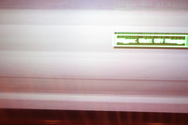

Well, the moment of truth came. I got my new HDFury unit and low and behold...the same problem exists. I will try to add a picture of my screen.
The first picture is with the BD player outputting at 720P or 1080I
The second picture is at 1080P. The message from the projector is "vertical synch out of range"
BD player @ 1080P. Says vertical synch out of range

BD player at 720P or 1080i setting

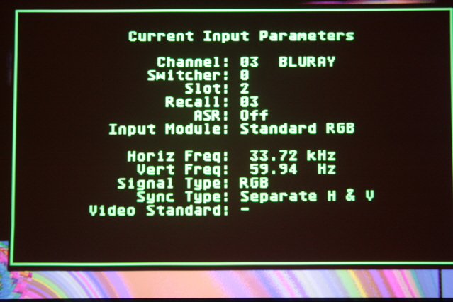

Does this help? When I press ** on the Marquee, this is the screen info
 Filesize:  150.17 KB
 Viewed:  12338 Time(s)
Posted: Tue Jul 21, 2009 2:11 am    Post subject:
33 is too low I bet, set your BD player to output 1080p@60. What Player is it?

Lets se the other info screens, whats your retrace set too?And your syncs.

That does not look like a Marquee problem. At least not the pictures posted.
"colors" clipping way out of gamut. You can clearly see that the nature if the artifact is digital.
Reminds me of how some old games looked when something went wrong.
And I wish the marquee had the ability to manage colors. But it does not. Not even when faulty.
I see no way for a Marquee to distort a normal image to that shown in the screenshot.
