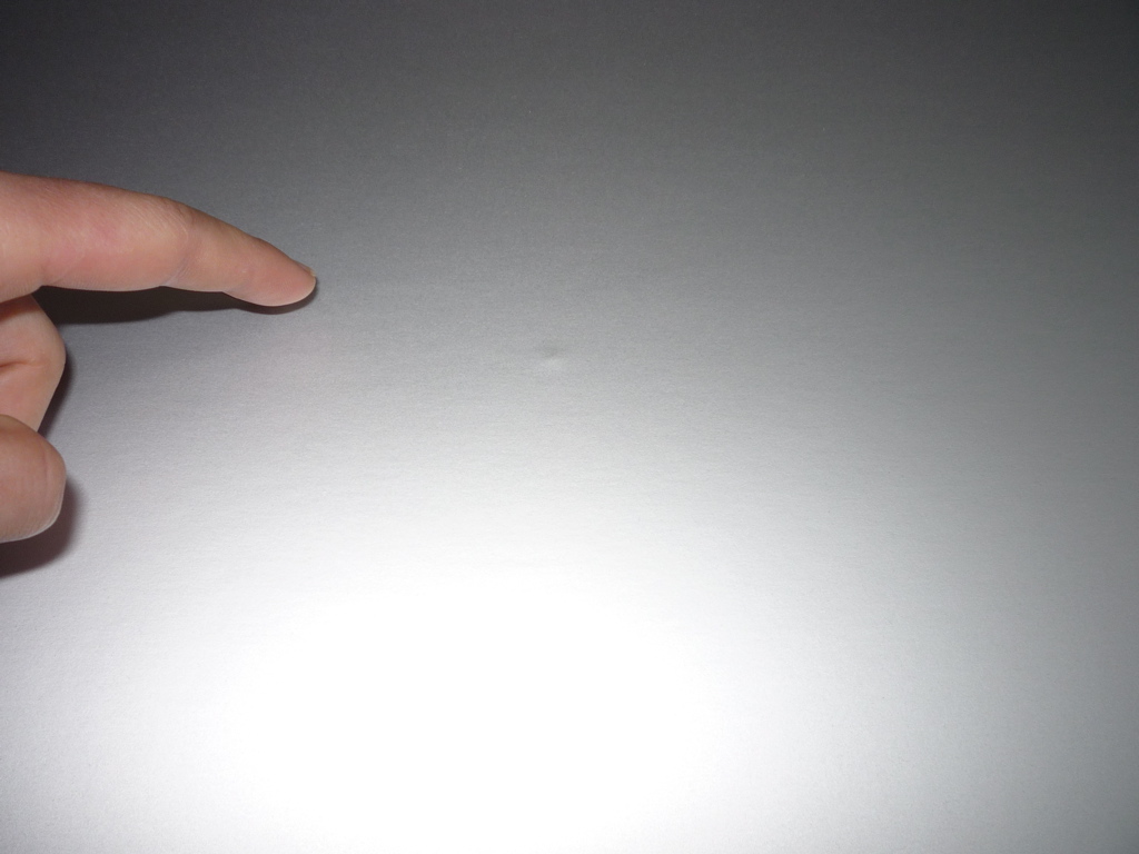

well, i got the silverstar. turned up with a manufacting fault (raised bump, about 5 pixels wide and 4 pixels high).
very visible in some circumstances, invisible in most.

pix

I am not sure if there is any way to get rid of that bump. You might be able to heat it gently with a hair dryer and maybe take a rolling pin to it.

looks like a piece of something underneath the surface layer.
our local vutec agent have been very accomodating though.

In that picture the hot-spotting looks pretty severe

it does'nt hot spot. there is no visible color shift either, unless you're at aan extreme angle.
the spot is apparent on certain scenes, mostly invisible until it SCREAMS on just the right material.

With a flash or a light on the surface, yes it would hot spot, but so would every screen on the market and every thing else. My wall has a hot spot with the lamp shining on it.

> looks like a piece of something underneath the surface layer. <
I agree. And unless the substrate (backing material) is soft enough that you could push the particle back into it, you'll likely make it worse. Even if you manage to flatten part of the bump, that will leave the smaller spot with a more obvious edge.
> our local vutec agent have been very accomodating though. <
That's good to hear. This is obviously a manufacturing defect (unless someone rammed a sharp object into the back), and for what these cost they should certainly take care of it to your satisfaction. Gain materials emphasize any defects in the surface.
