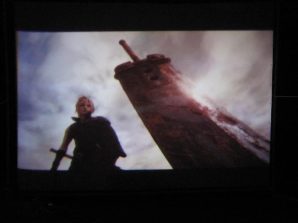

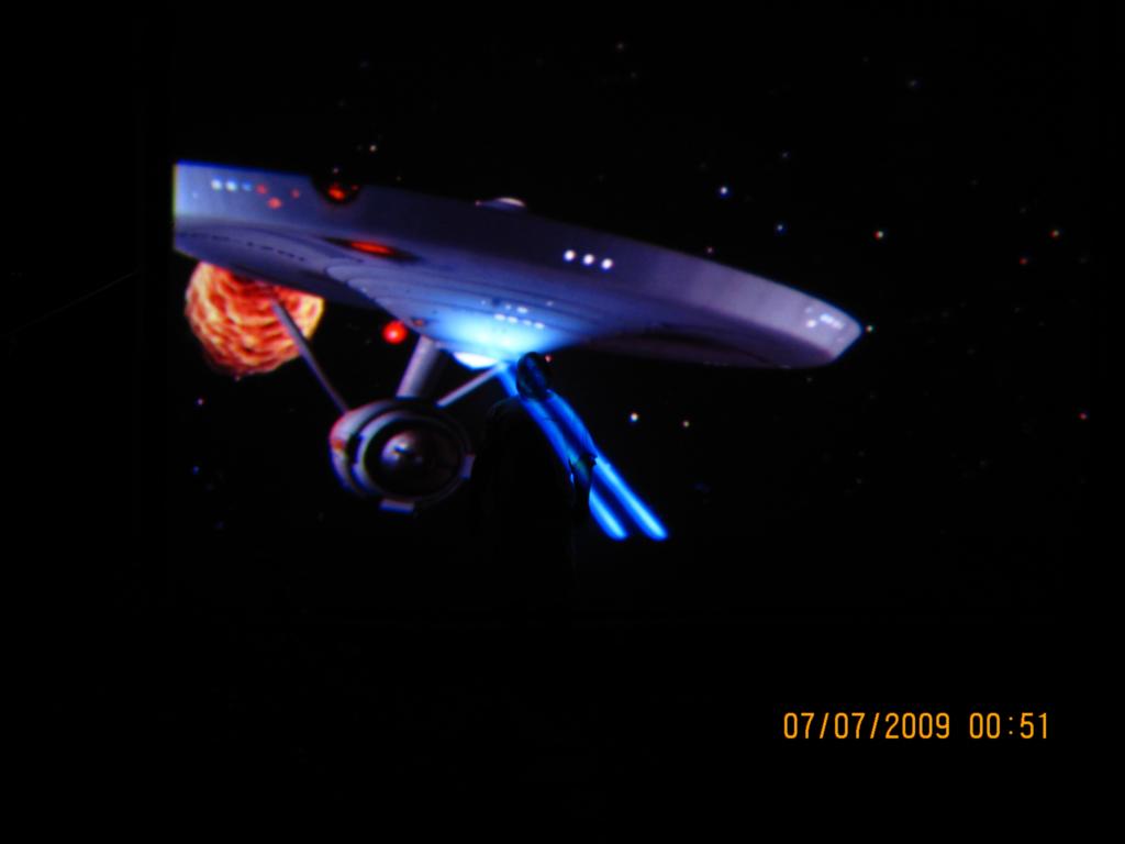

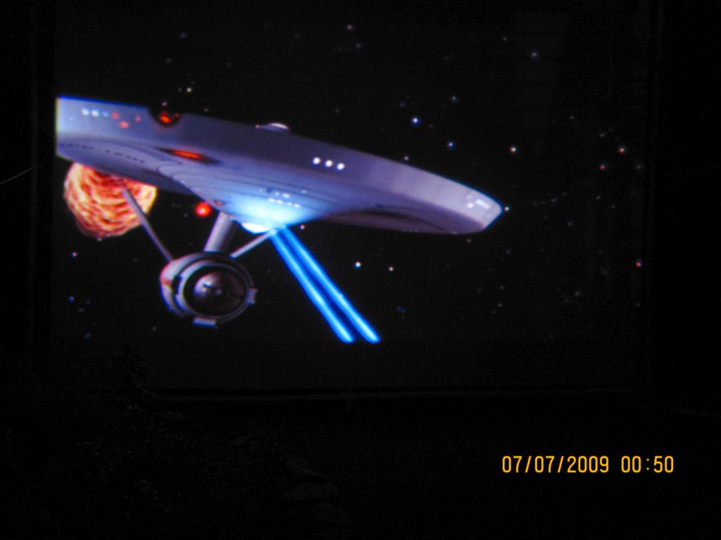

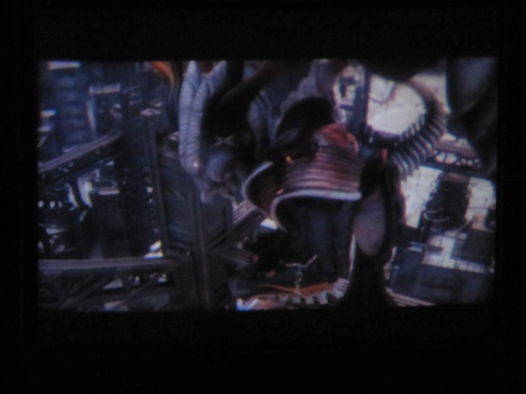

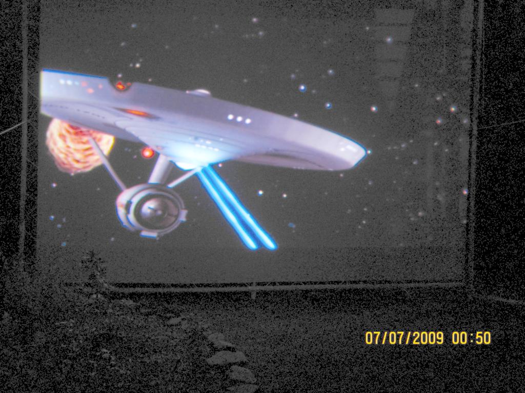

So, here's a few better pics of our 17'x12.75' screen at dusk - the BG800 seems more than up to the task (even though it is temporarily 8' too far from the screen). Not yet calibrated properly (it is in it's temporary position, and we are mostly playing at the moment - will calibrate and set it up properly when it is in it's permanent spot). So, for now, this thing is FAAAAR from calibrated in any way.
Amazingly, the PJ is more than bright enough for the task - even at dusk or dawn (see pics). I am very impressed.

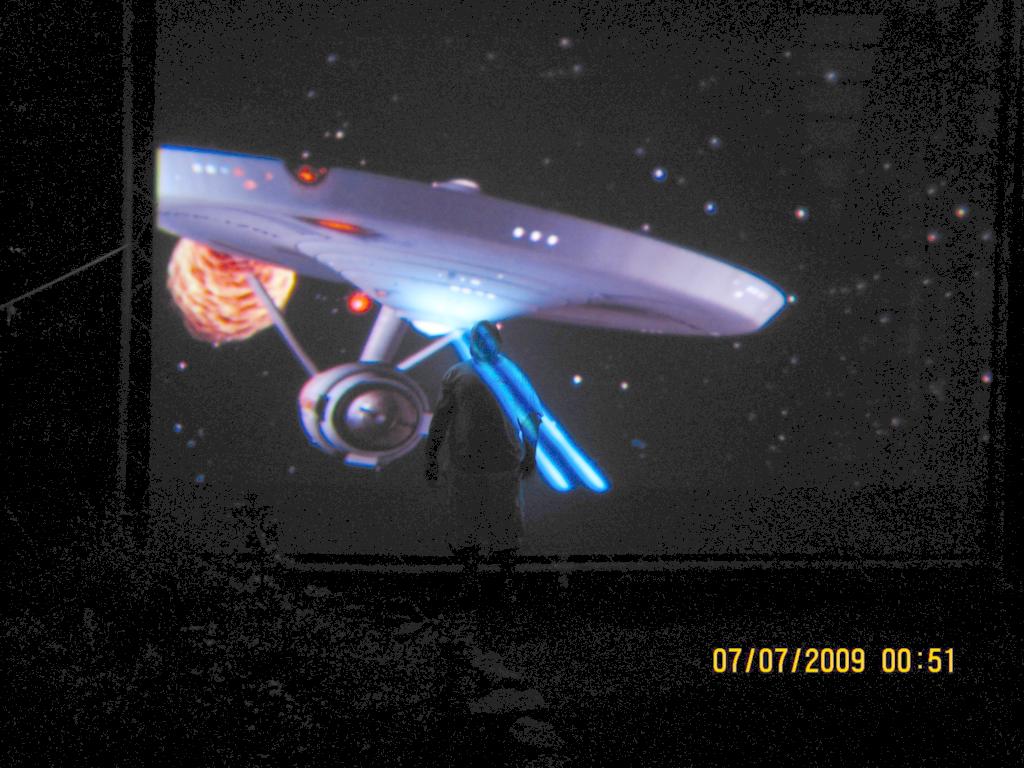

Here's a few more pics...
Obviously, I am a big Star Trek TOS fan, so when I am not at my regular day job, or playing with this projector, I am making Star Trek New Voyages/Phase 2 episodes like the one this image is from: STP2's "Blood and Fire Part 1" (c) RFS
 Filesize:  44.33 KB
 Viewed:  8951 Time(s)
Gamma adjusted so you can see how the screen is rigged and such
 Filesize:  149.66 KB
My brother in front of the screen as a size comparison...
 Filesize:  26.65 KB
Gamma adjusted so you can see my brother in comparison to the screen...
I still want a bigger screen... got 3'x2.25 feet to go to the PJ "limit
