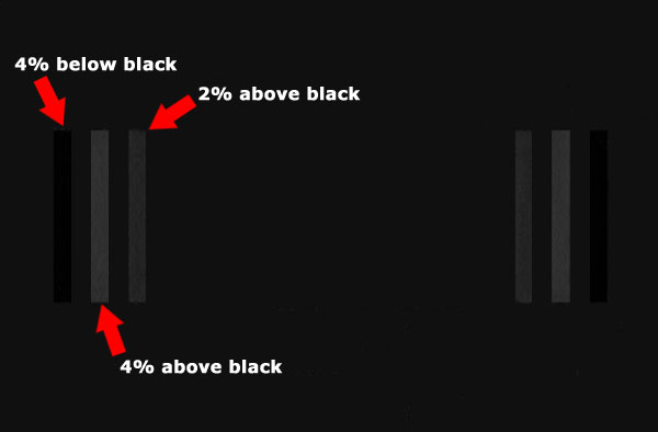

My Eyeone pro has a difficult ime with readings below 20% IRE, so I tend to set the black levels with the pattern shown in the GreyScale Calibration for Dummies Tutorial:
"Part 5: Setting Black Level (Brightness)
The brightness control adjusts the black level on your display. In other words, it sets the level when the darkest objects become visible. As mentioned previously, setting it too low will cause darker details to be lost into black (black crush). Set too high will cause black to appear grey. Brightness affects all colours at the same time.
Setting brightness is pretty straight forward:
STEP 5.1: Every test disc has what's called a PLUGE pattern (which stands for "Picture Line-Up Generation Equipment" because of the equipment that used to be used to generate greyscale test patterns). They all have a blacker-than-black bar, a black bar (often just the background) and one or two just-above-black bar(s). Skip to the PLUGE pattern on the Digital Video Essentials: HD Basics disc by choosing menu option "Complete Program Menu" -> "Advanced Video Test Patterns" -> 1080p or 720p -> "Video Black w/ new PLUGE".
The Digital Video Essential disc has one blacker-than-black bar and two just-above-black bars like this: [b](See attachment below)[/b]
Note: The 4% below black (blacker-than-black) bar may not be visible on your setup. Not all setups will display blacker-than-black (or whiter-than-white) content. While your system will have a slightly reduced video range, you typically will not be losing out on anything if you cannot see this content.
Incidentally, all of the greyscale window patterns from 0 to 100 IRE on the Digital Video Essentials: HD Basics test disc have these PLUGE patterns to the left and right of the image. We use the one that is dark (0 IRE) to make the PLUGE pattern easier to see.
Adjust the brightness control on your display until the 2% above black bar is barely visible and the 4% below black bar is invisible. (The 4% above black is just there for reference). That's it! Simple! You're not supposed to see the 4% below black bar as it is content BELOW black. If you adjust brightness too high such that that 4% below black bar is visible, your black level will be too high and things that are supposed to be black will instead appear grey."
