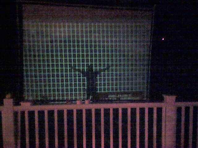

Anyway, here's a couple images... (from my crappy cell phone camera... sorry, I know the cam sucks... better ones when we are done).
And thanks to everyone who has helped with info, advice and tips!!!
Rob
Me standing in front of it with my arms raised.

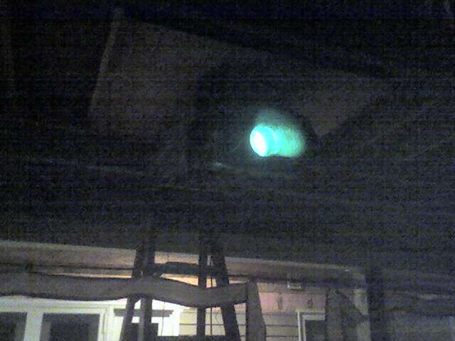

Up, cover off, green only for alignment pattern... bug screen in way (cutting hole tomorrow) which is cutting lotsa light (and causing the 2nd green glow to the right of the lense glow).

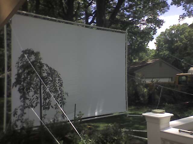

Here's a daytime pic of the screen. Built using 2" PVC (we wanted 3" but it woulda cost over twice as much) and blackout fabric (the lady who sewed it for us pinched the fabric a little on the seam, but oh well - decent enough for an xBox/movie night for the 4th).

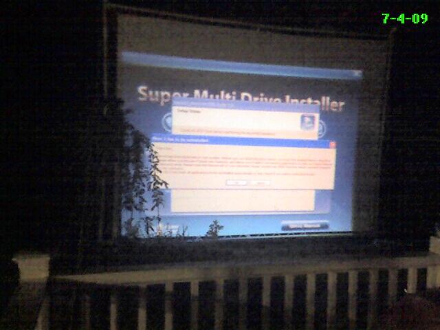

Attached is a terrible cell phone cam pic. I had some friends with a real camera take some better ones. Will post those once I get them.
This pic, btw, was taken before we cut the piece of porch/bug screen away from in front of the lenses - doing so made the picture twice as bright (any of you who have done film lighting know exactly what a piece of screen in front of a light source does (ie: scrim, net, etc) - this was a thick, heavy duty, small weave screen).
And of course, as indicated elsewhere (by the idiot me - who messed up), I screwed up when I placed the screen. I used the diagonal size from the lense program to calculate the distance at 1.3 - I should have used the width. So, it is a little dimmer still than it should be, as instead of being 29' from the PJ, it should have been 22'
Ah well... something to fix before our next outing.
at midpoint on Contrast and Brightness, with half the light cut by a thick bug screen, it's still very bright at 29 feet from the PJ.
