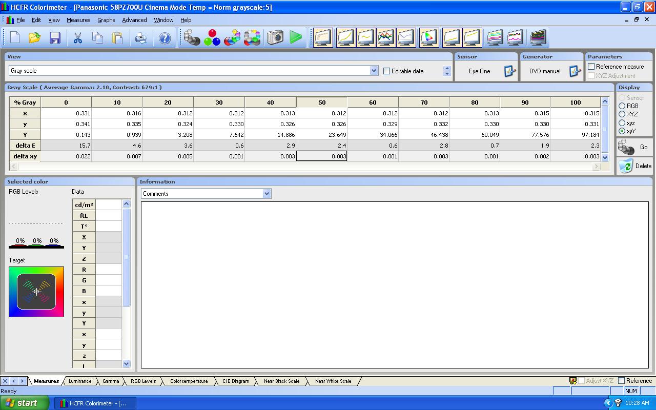

I calibrated my Panasonic th58pz700u in cinema mode, temp set to normal. Attached are my final readings.
Viewing content seems a bit dark. I thought I read somewhere that the HCFR Gamma reading of 2.2 really measures 2.5. Can anyone confirm?
I have a question, should you go back and tweak color and tint in User Menu, or are the settings now considered optimal?
Still having trouble using CalMAN, which I figured would be the easiest. Most of the instructions seem to be for the HTPC Generator.
Eventually I'll get the hang of it.
