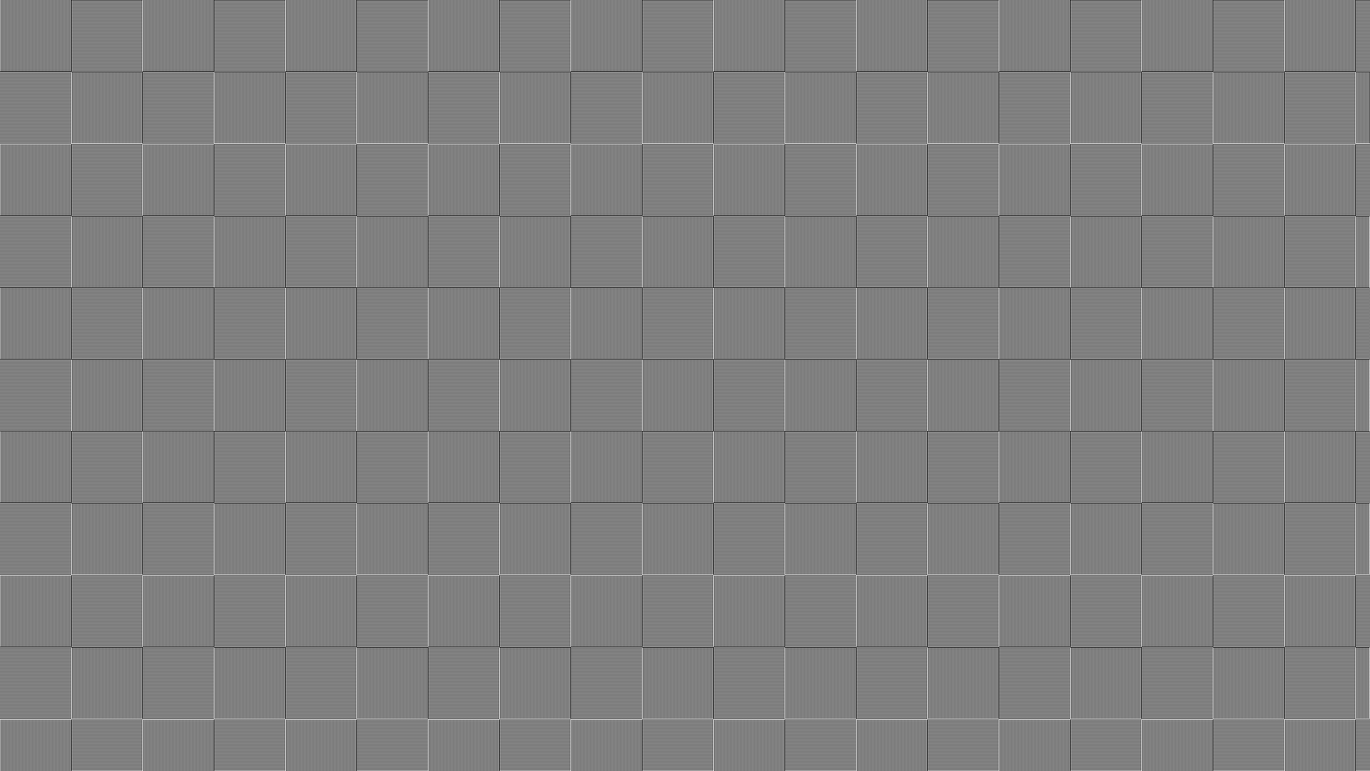

While it's true that you can't see ALL of the source resolution, you can see MOST of it.
Out of curiosity, how much of the 1080p resolution are folks seeing?
Mine isn't fully 100% resolving it, but it does darn well. Try displaying the attached 1-on-1-off pattern if you have an HTPC or PS3. On my 8500 the horizontal lines are fully and cleanly resolved over most of the screen. The vertical lines are a bit beyond the 8500's bandwidth capabilities, but they're still there. If you view this pattern from a distance, it looks like a checkerboard, because the vertical-line squares are significantly darker than the horizontal-line squares. But looking up close, you *can* see the individual lines even in the vertical sections.
I figure if the projector can visibly resolve 1080p vertical 1-1 lines, it's going to show at least 90% of the actual picture content in any Blu-Ray movie source.

Posted: Sat Jun 06, 2009 6:56 pm    Post subject:
Ummm, no they're not Smile there is simply not enoughtspace on the 8 tube to firt them vertically with the raster squeezed.
I agree with that , on a well set-up and good running 8500 you should see 90% of 1080P content.
Posted: Sat Jun 06, 2009 8:13 pm    Post subject:
draganm wrote:
Eh? What does raster squeeze have to do with vertical lines (horizontal resolution)?
Horizontal resolution is all about the control of the beam current - the video amplifiers' bandwidth and slew rates. While the area a 9" tube provides certainly makes it easier to get a sharper image, no CRT projector that I'm aware of can perfectly faithfully reproduce alternating black/white lines (a square wave) at the high frequency 1920x1080p requires. Luckily, we don't watch alternating vertical black/white lines in movies, so it isn't an issue on 99.9% of program material.

But the alternating black/white lines do an excellent job mimicking the the line-pairs that our eyes need to discern one piece of information from the next. Smile

Posted: Sat Jun 06, 2009 8:35 pm    Post subject:
Gary said that 1080P vertical lines are beyond the MArquee's bandwidth, inplying that a MArquee electronics cannot fully resolve 1080 vertical ines. that's far from true, with raster expanded vertically to it's normal range, scan lines for 1080P are very visible even on an 8500. The problem lies when you squeeze the vertical size down, they will overlap on an 8500 and not fully resolve each line. since a 9" tube is taller, you should be able to squeeze it down and still be able to fully resolve 1080.
Posted: Sat Jun 06, 2009 8:45 pm    Post subject:
True, but the black/white lines represent a worst/best case scenario - a situation which rarely exists in program material (or in the real world for that matter). If you're you looking at anything lower-contrast... say, 30 and 70 IRE alternating lines, the projector will more faithfully reproduce it, but your eyes will be less capable of discerning it (or you'll need to be closer).

Posted: Sat Jun 06, 2009 8:49 pm    Post subject:
You're mixing up vertical and horizontal. What Gary was referring to was that the Marquee can't resolve *1920 VERTICAL* alternating black/white lines perfectly... It can't (no CRT projector can), and raster squeeze has nothing to do with that. I think Mike Parker has pushed these bad boys about as far as they'll go - and they're damn good - but, it's still far from a perfect digital-style square wave. Fortunately, that's not a problem. We wouldn't like if if they could reproduce that square wave perfectly... It would just faithfully reveal the pixels in the source... Something we CRT'ers are happy to avoid.
Slightly touching scan lines and a touch of horizontal bandwidth smear isn't necessarily a bad thing.
